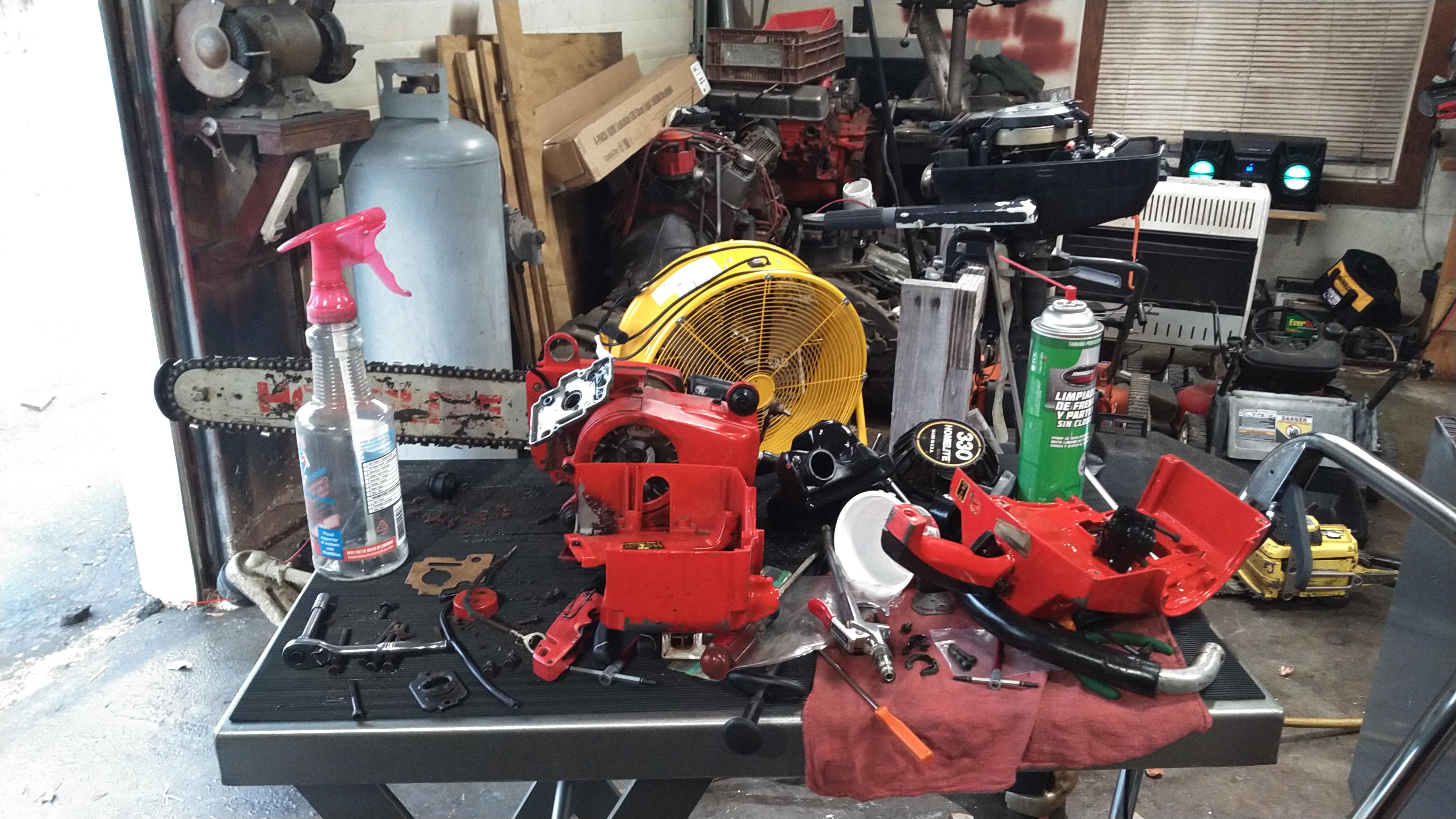

Homelite 330 intake boot fun!! Actually not too bad to get apart. Replacing pulse and fuel lines while it's apart as well.
Yes, I've done a few of those. Make sure your anti vibe mounts are solid or it'll tear up the new boot.

On the 330 those vibe mounts are too soft.
Years ago i went thru 3 boots until i replaced the mounts with some rubber donuts off of some car shocks. Much stiffer and no more boot issues.
Yes it was a backyardigan fix but it worked.
It's just a Homelite 330.

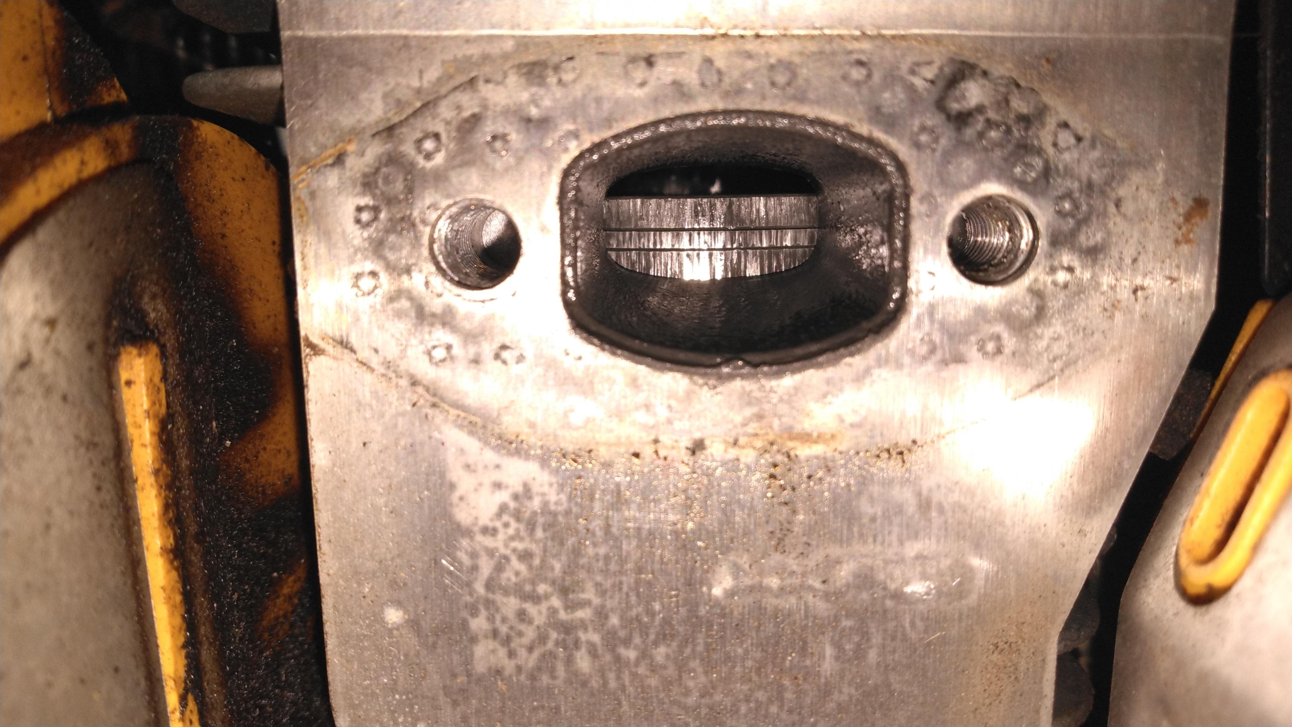

Weedeater hedge trimmer. Came in for hard starting. Checked the usual fuel condition, pulled muffler checked piston was ok, spark arrestor screen was clean however it was oil soaked so I heated it red hot with my torch. Pulled carb apart and metering diaphragm was pretty stiff (it only gets used a couple of times a year) and ordered carb kit and kits for my stock. Will rebuild carb and advise him to use Tru Fuel since it's used infrequently.
