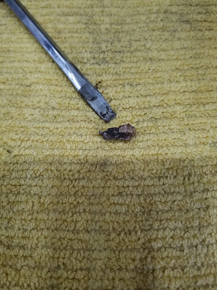

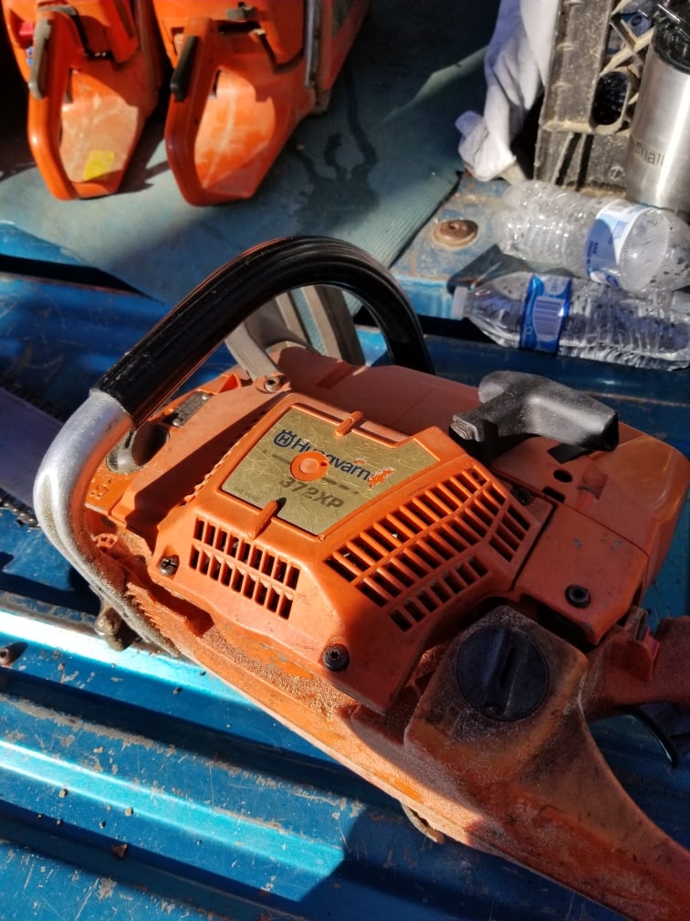

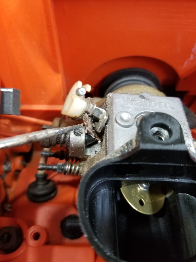

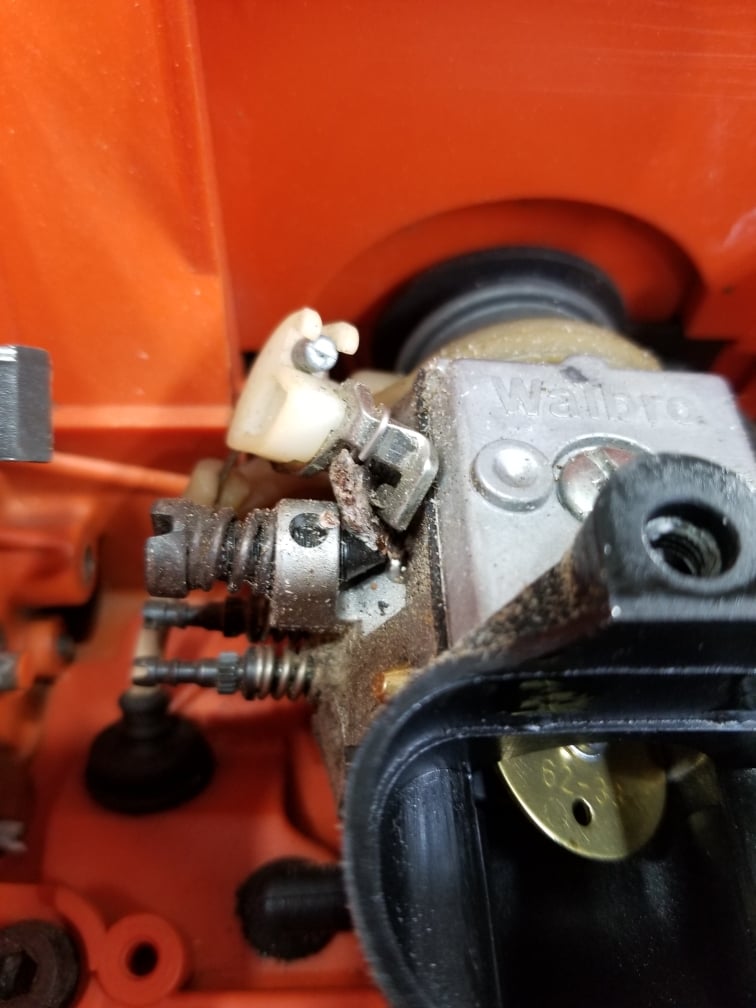

Most likely will be this old girl, was bucking a 24" tree I felled this morning and all of a sudden while in the cut ,went wide open throttle and only thing I could was kill it with the switch. Wondering if she blew a seal and started sucking air
Well I figured out the wide open throttle problem, lol,kinda stupid on my part. A piece of bark was stuck in between the throttle stop and lever.
That puts a new spin on pulling the limiters!!! Lol nice find!

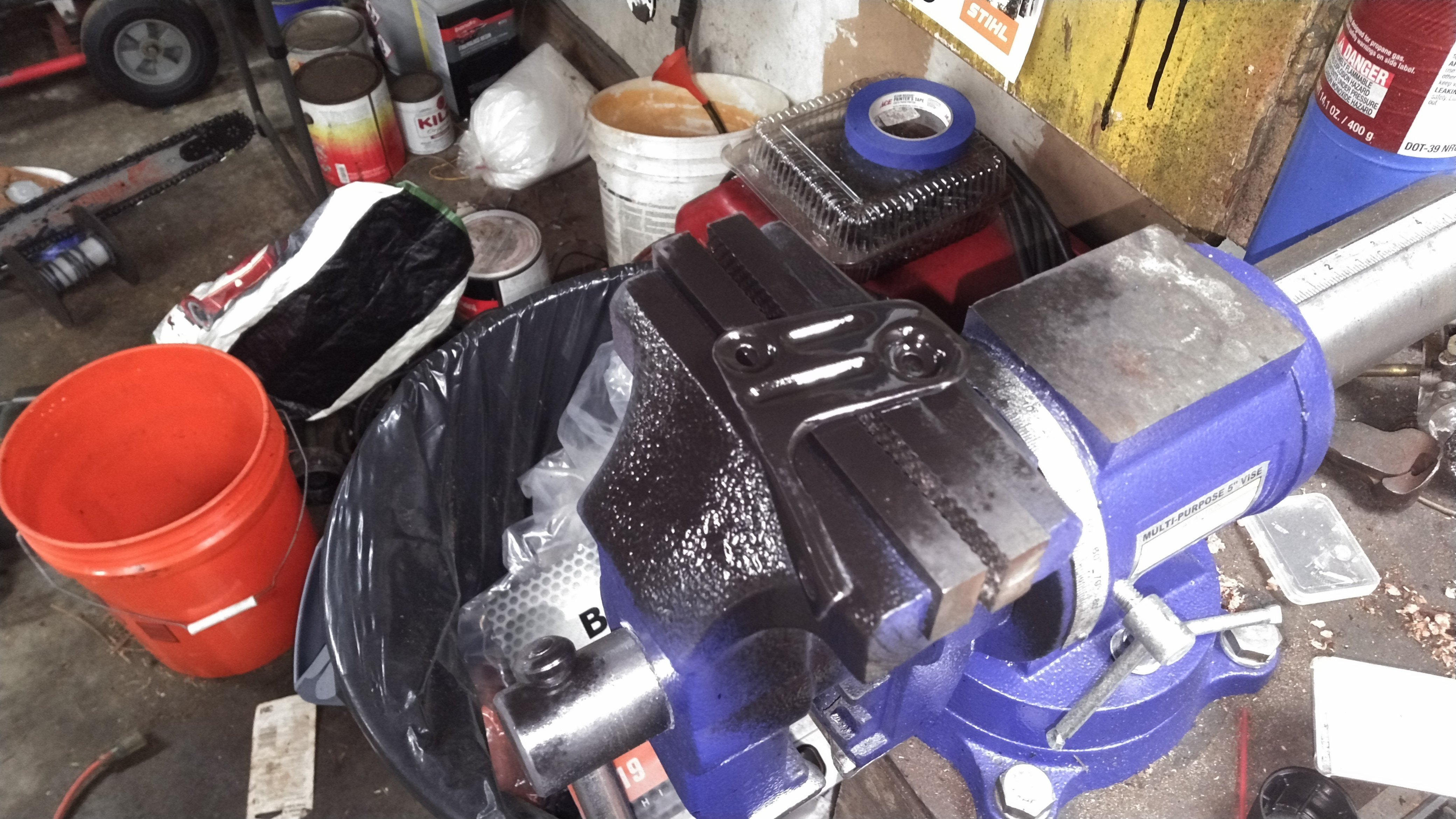

Modified and painted the muffler bracket for my 346xp conversion. Also took a ride to the saw shop this morning and picked up a loop of RM, a Spencer 50' tape and nail, and a t-shirt and calendar.
Lol limiters, what limiters. Thanks, I was super excited it wasn't an airleak. Should have looked closer the other day, but had to get cutting so I just grabbed another saw.
