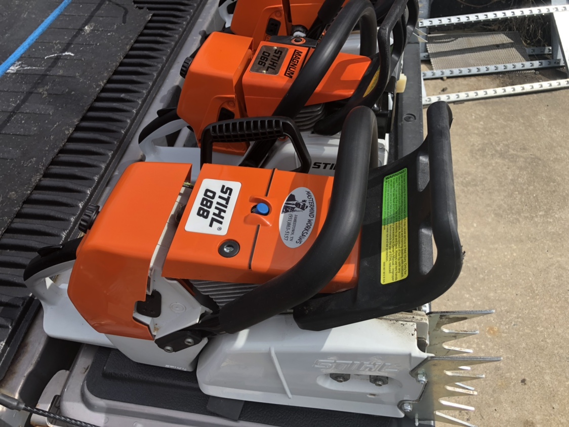

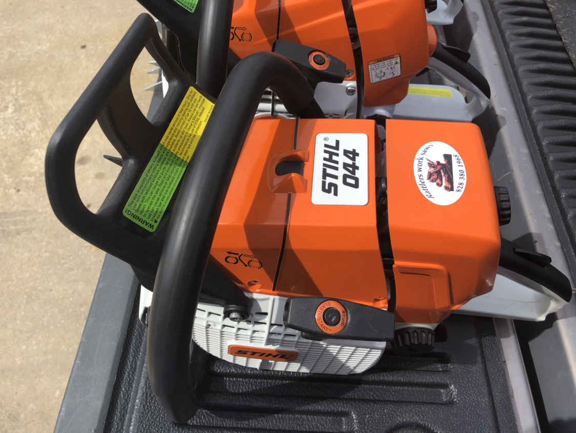

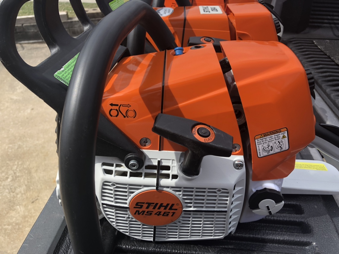

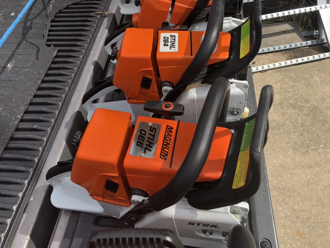

Saws that got fully powdered and rebuilt in the last 8 months just 064 off bench
Im done doing saws for myself but ill do parts and the Fleetwood on the bench next

Beautiful saws Mike, beautiful work as always.
