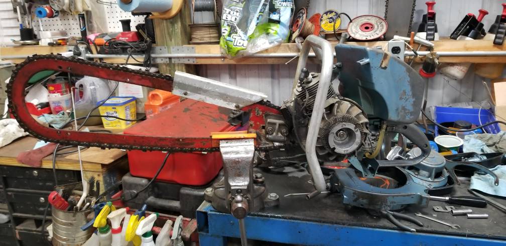

Homelite Super Wiz 66 gear drive with a clearing bar.
