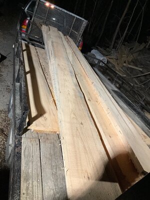

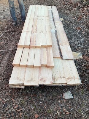

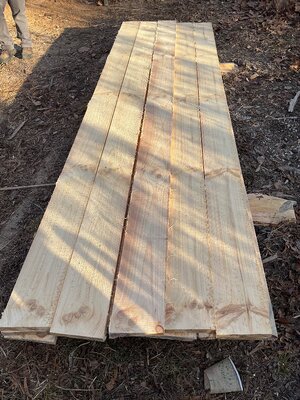

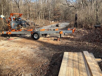

Milled some ash and pine this afternoon.

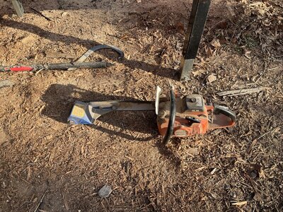

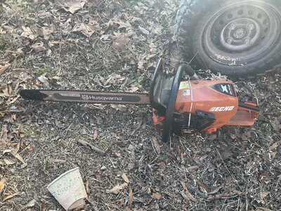

A much newer one with its mismatched bar. Man, this saw rips ported.IMG_0832.jpeg

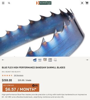

I went to the norwood website there blades are 50$ a pop

Ok cool i missed that blade i saw the stellicut box of 5 for 250$

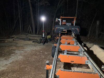

EFSM, those lights look like they give a pretty decent color/temp.
