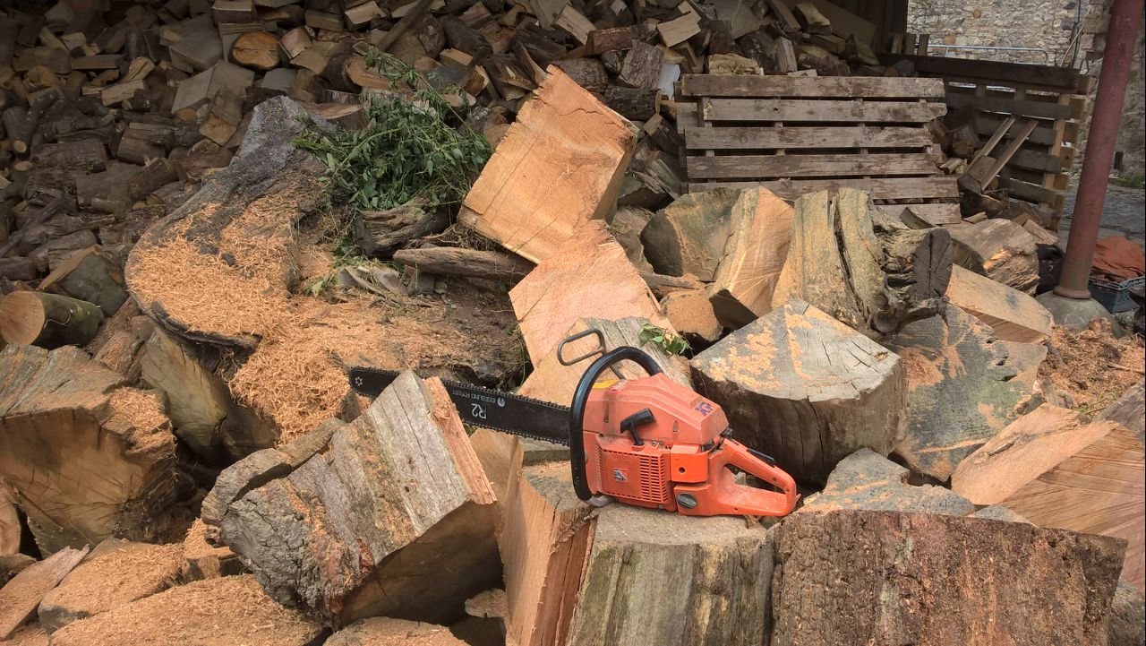

Rapeseed all their lives, and I still have both of these bars. One is four years old, the other five years.
Bridge ported MMWS:

In fairness that Stihl bar is pretty damn hard. The Black 30" Iggesund Forest bar shows a lot of wear - but she started life on a 281xp. They are both spares now.
Keep your chain sharp, set the oiler to max, and don't do crazy stuff like milling, and yer fine.
