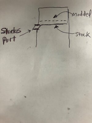

Interesting … rather than use words a pic might show it better. If stock piston is used and the cylinder was dropped by “x” amount (lathe cut) the cutouts on the piston are going to open the stratos later vs where they opened stock. IMG_7234.jpegI’m speculating this most likely won’t make a lick of difference at 10000 rpm in the cut tho I’ve never tried building a stratos in this fashion. Any tips appreciated

Interesting … rather than use words a pic might show it better. If stock piston is used and the cylinder was dropped by “x” amount (lathe cut) the cutouts on the piston are going to open the stratos later vs where they opened stock. View attachment 473471I’m speculating this most likely won’t make a lick of difference at 10000 rpm in the cut tho I’ve never tried building a stratos in this fashion. Any tips appreciated
Stratos open earlier than stock after lathe work, just like the intake. They usually open about the same time, as that’s how it works, fuel and air goes in the bottom and a layer of air is sucked through the strato ports and into the upper transfers. The strato ports are visible through the intake, but they open on the way up when the cut out in the piston reaches the bottom of the upper transfers. Not visible when it happens

I’m referring to the power-stroke when the piston is being forced in a downward direction. I wonder IF a small hole or tunnel connecting the stratos to the intake might just make a fuzz more powa at “in the cut rpm” - should get a bit more fuel in theory, then again the “theory” can be off by quite a bit when you actually test the saw.
It would need to be in a spot that wouldn’t affect case compression on the way down and up. Like a finger or boost port
I’ve seen builds where the stratos ports were gutted / divider removed and yes I believe it would increase the output , however the fuel mileage might be unbearable.
