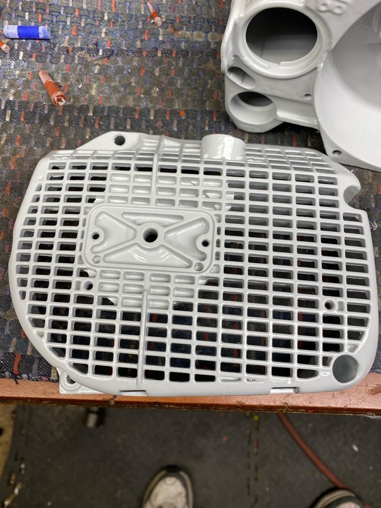

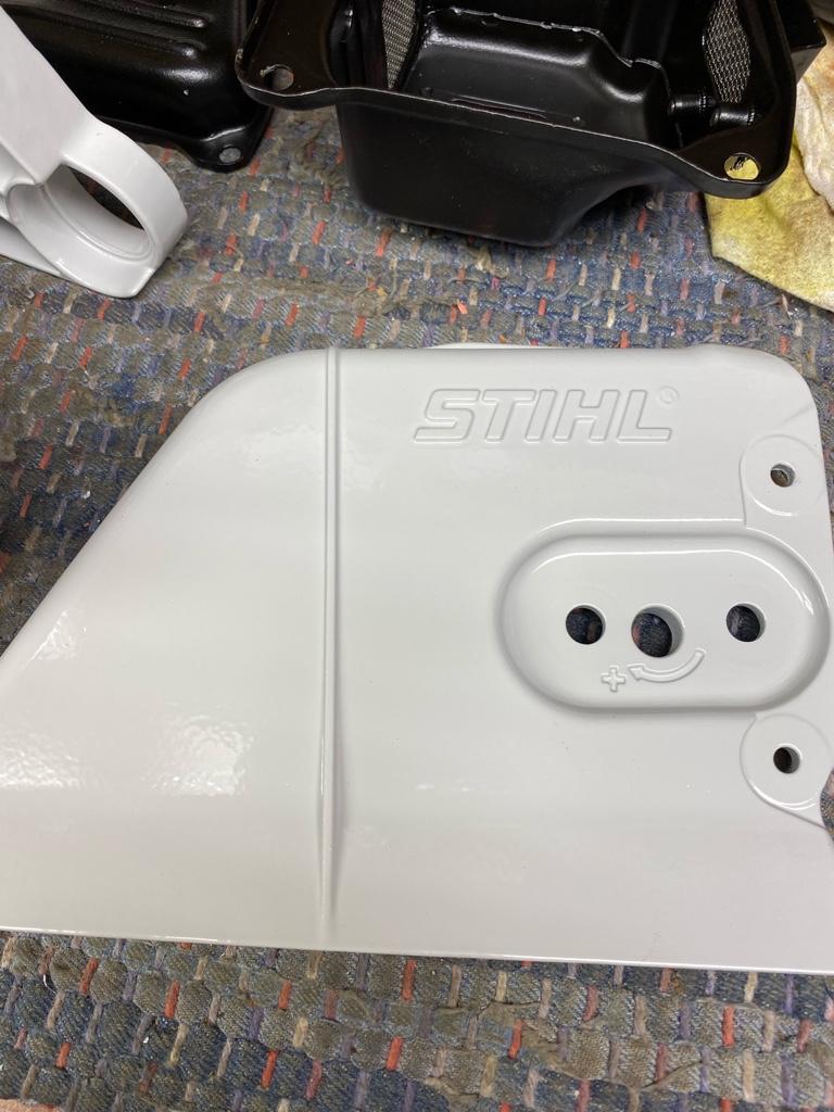

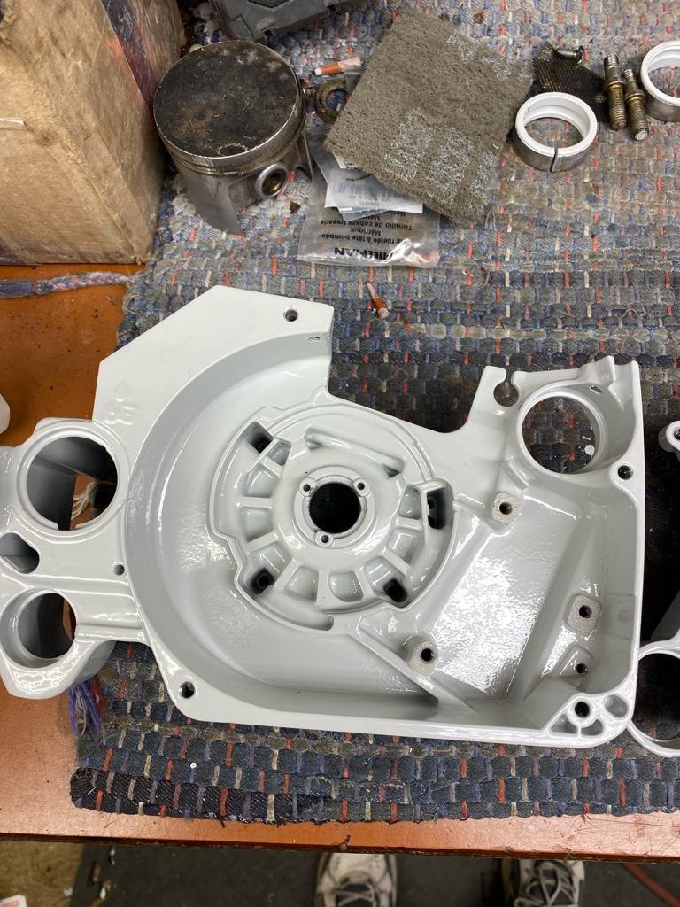

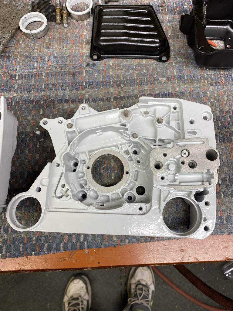

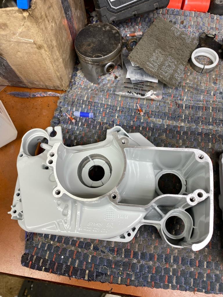

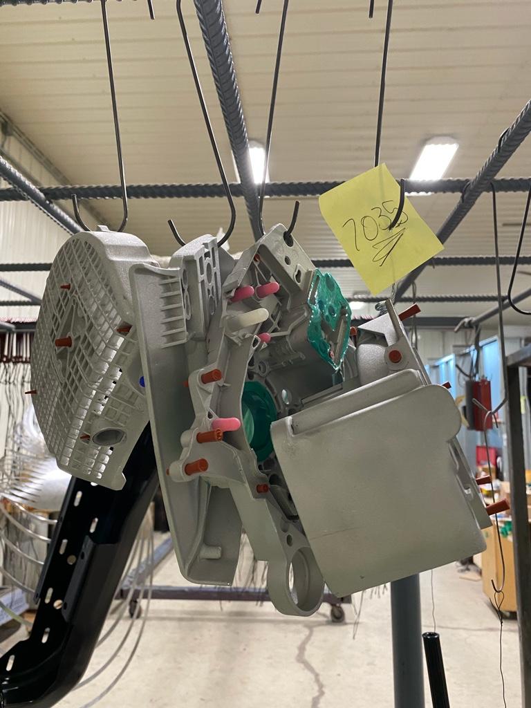

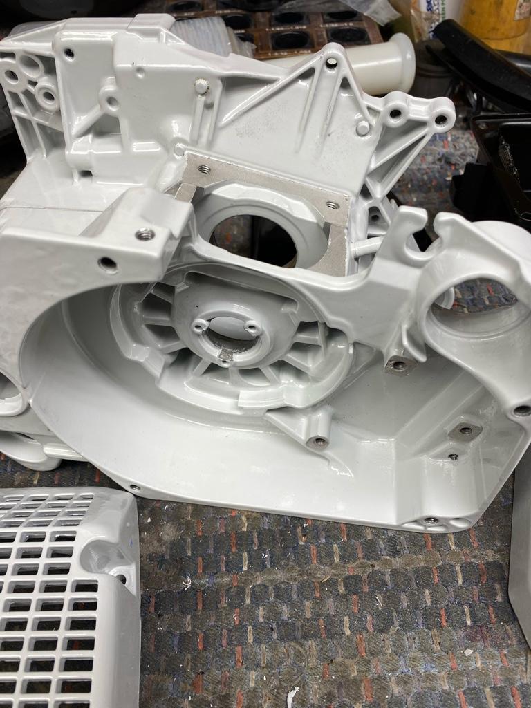

All parts blasted and cleaned masked and plugged already for powder
