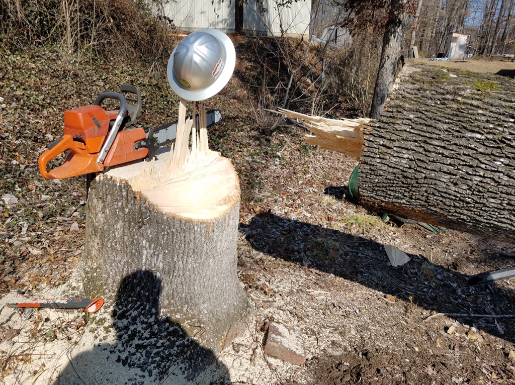

That wouldn’t fly here in the east tearing a lot of fiber loggin high $ hardwood trees, unless your just using it for firewood or not selling it. Seems like a different ball game out west. It is interesting to see the difference in styles of logging for the type of timber your cutting.
Notice where the fiber was mostly pulled from.

Ash with some natural lean. No bore cut but a little fiber pull. I cut one beside it a couple years ago and bored into and when I got the hinge set it set down on the bar. The wedges in it wouldn’t lift and not enough room for more so it had to be pulled over
