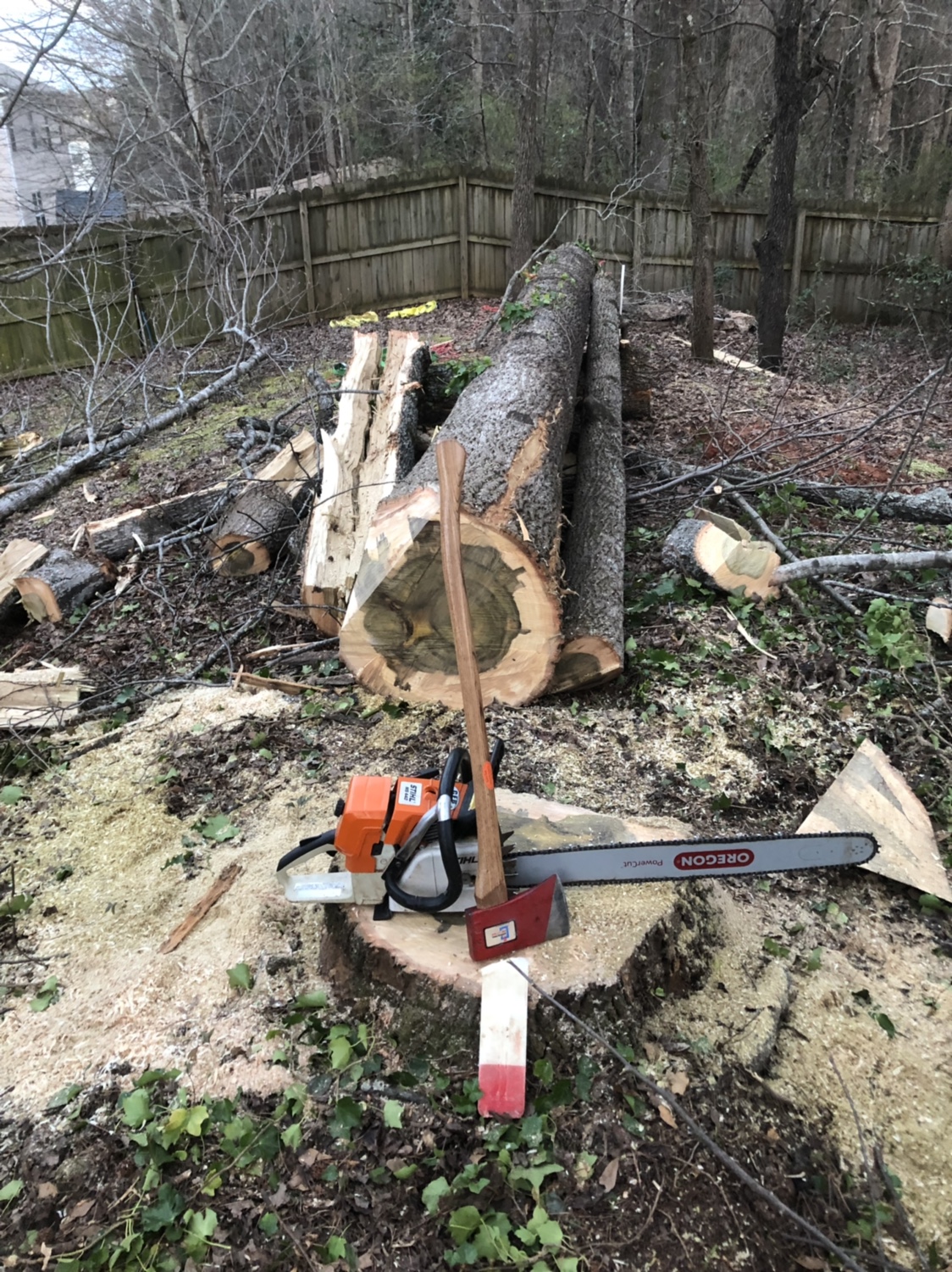

Ash with some natural lean. No bore cut but a little fiber pull. I cut one beside it a couple years ago and bored into and when I got the hinge set it set down on the bar. The wedges in it wouldn’t lift and not enough room for more so it had to be pulled over
Howdy Mike. Hope all is well over there.
Why do you think the previous one sat down? Was the tree rotten on the inside?

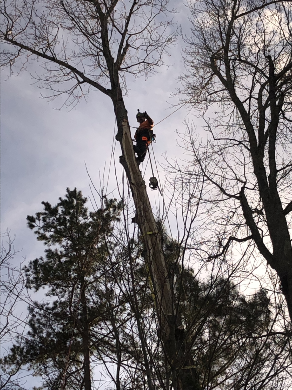

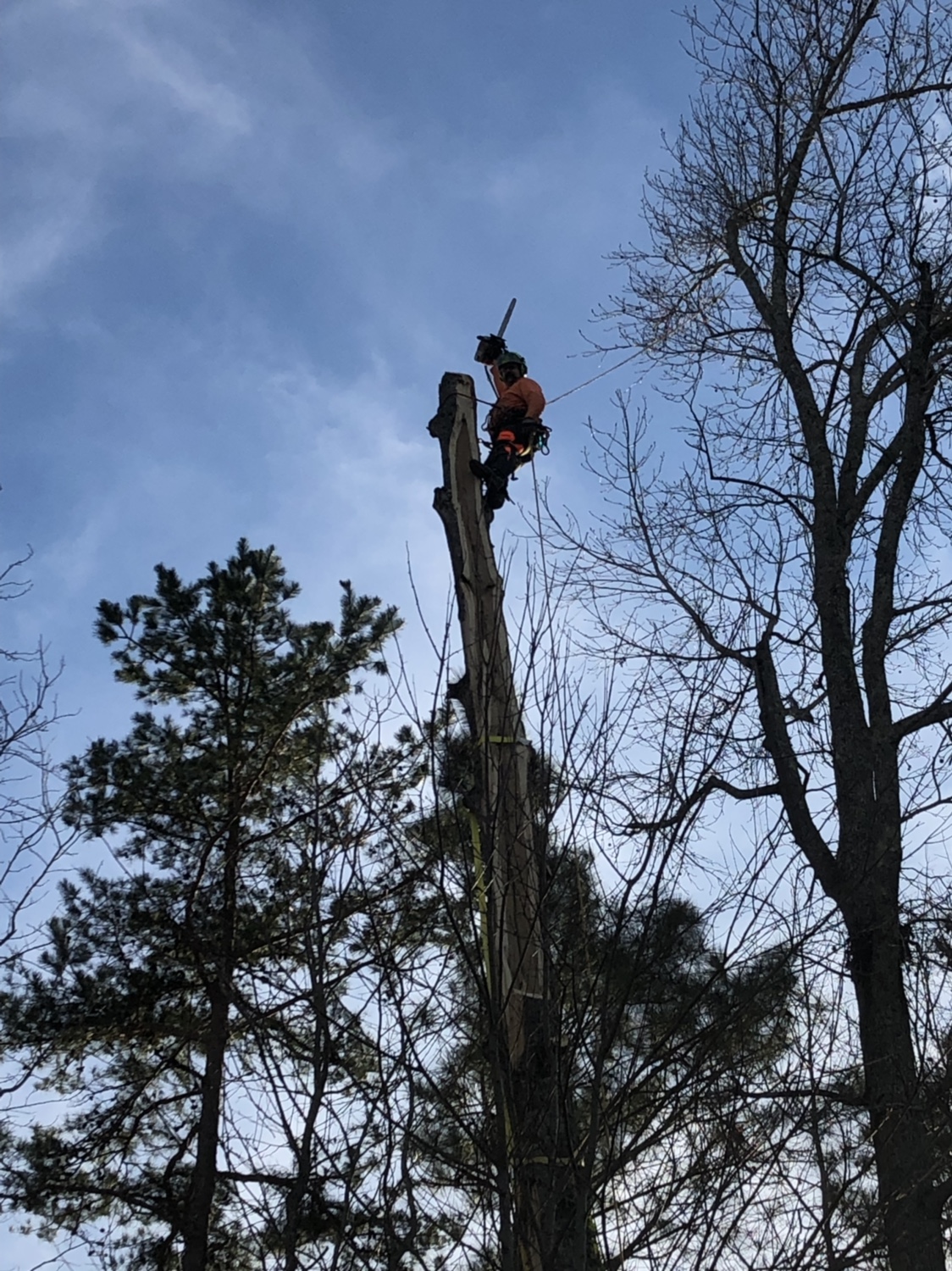

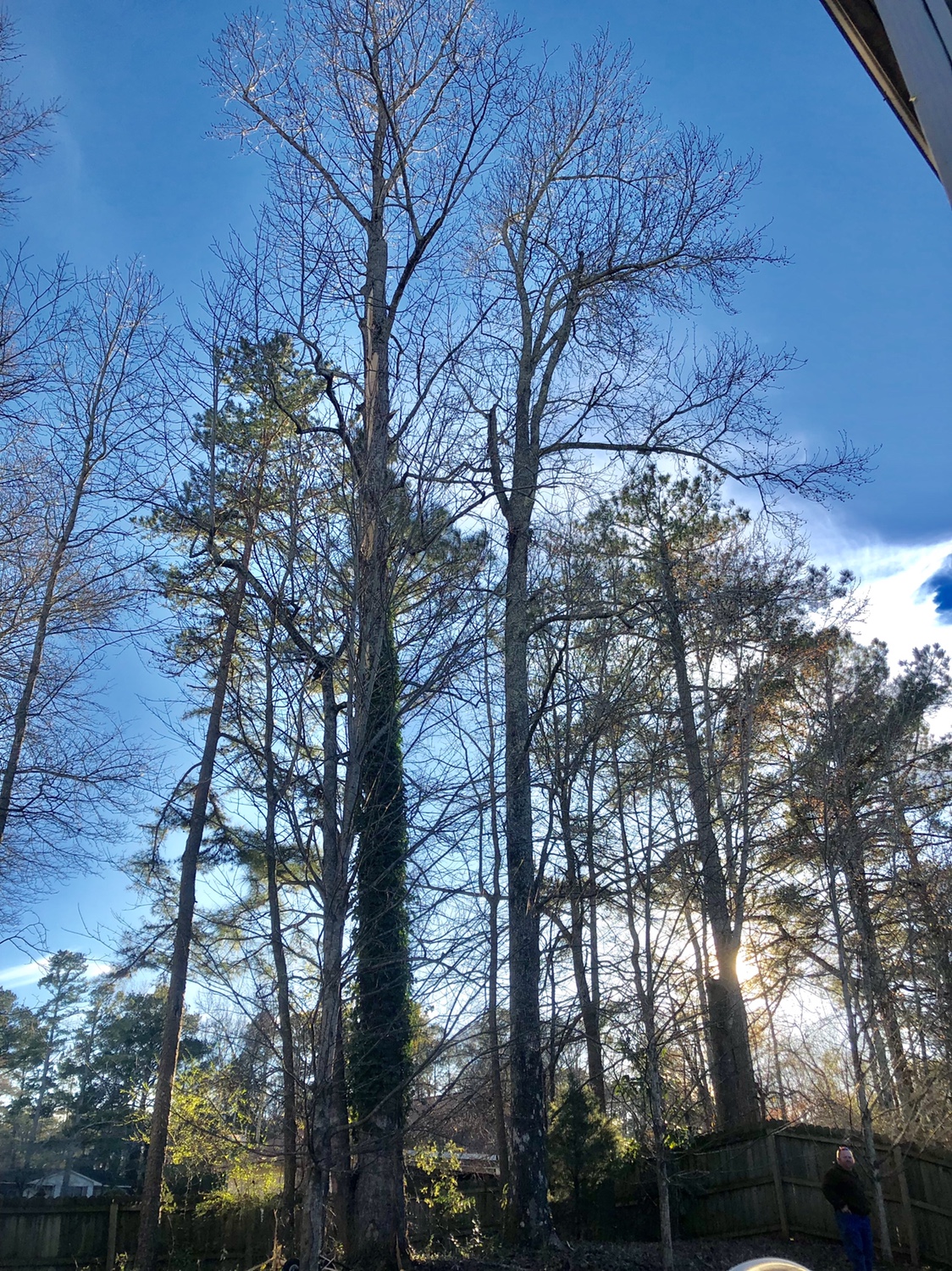

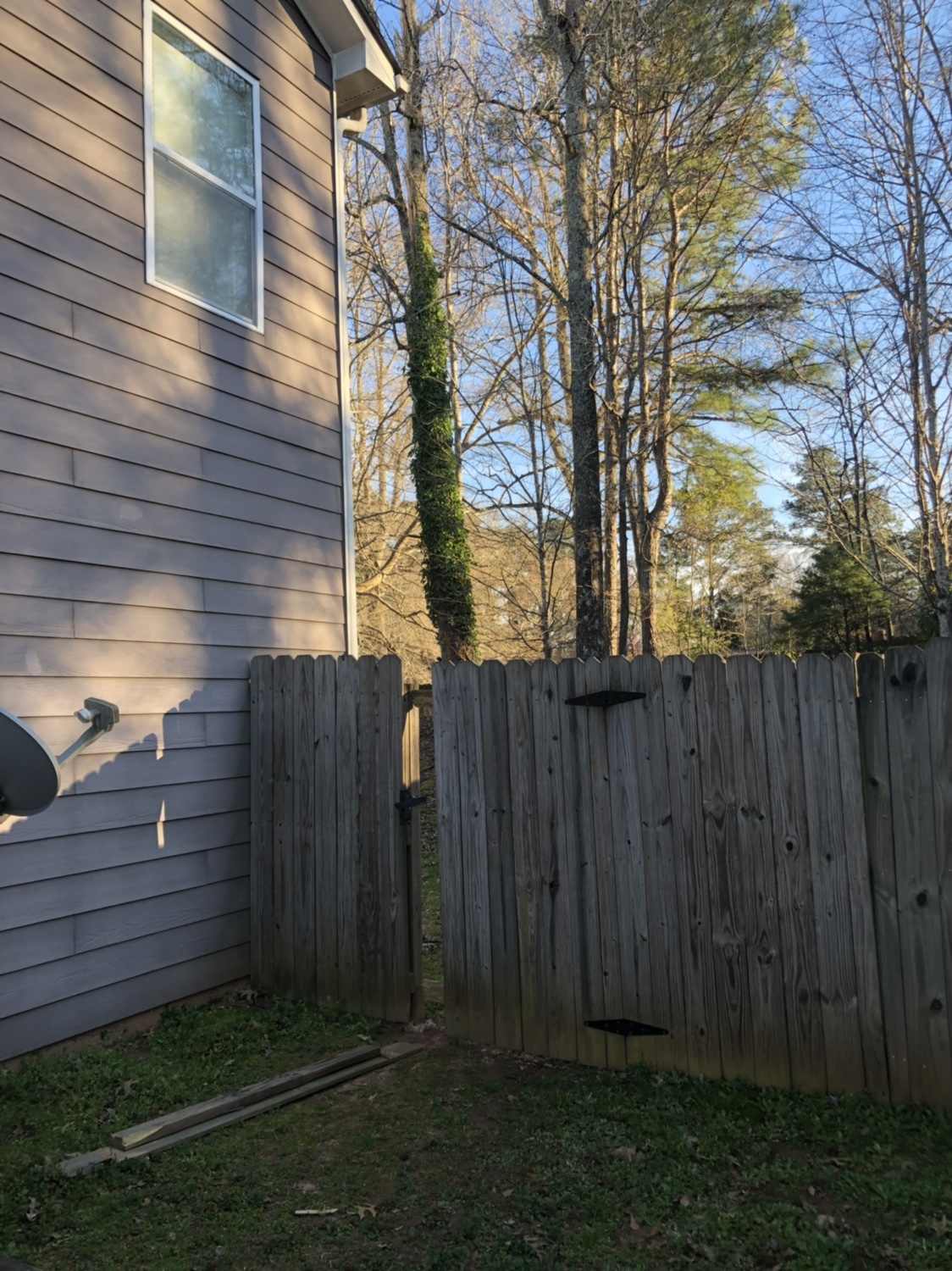

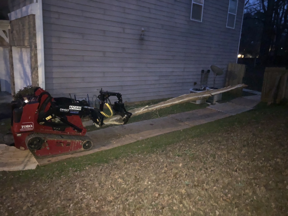

Here’s a gnarly one from yesterday.
Preface- This is a Danger/Hazard Tree.
Please do not take on one of these without Adequate Knowledge & Skill Set.
Lightning Struck Poplar from last week’s storm.
Bark Yard & fence in Subdivision. The only straightforward access is the gate.
Great Climber & Friend. He’s just joined the forum.
See him tied in to an adjacent tree?
Also notice the Trucker’s Straps holding the Stem together. This thing was split from within 25’ of the top, all the way to the bottom.

Wait,
This is the felling forum.
My Mistake.
It’s on the ground that’s what matters with no damage hats off to you guys. From time to time there’s days I miss picking up a saw but it’s sure been nicer having the saw carry me.

I bet there's some nice looking boards in that butt log.

It had a small spot maybe 4” round that was hollow in an 18-20” tree. Never had a good healthy looking tree like that do anything like that before with a hinge and the back trigger area left

Is that Husqvarna axe in the pic?
