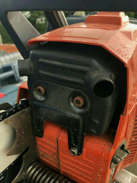

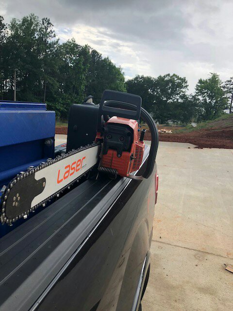

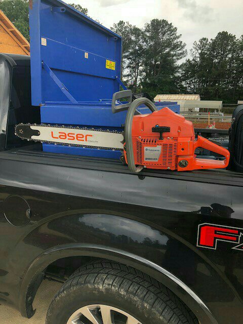

Picked up this minty 288 in NC. Got a chance to run it yesterday I see what the hype is all about. Makes my picker stick out just a little
