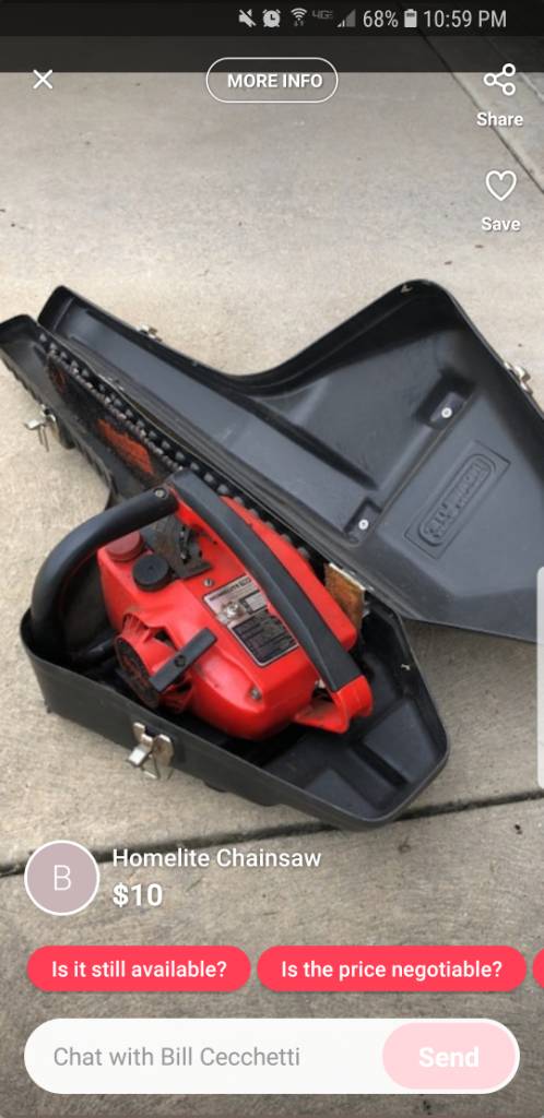

I got a line on a decent homelite xl2 and an old remington sL9 not really decent. Not bad but weathered. Reme runs not sure about the homelite yet. What u think there worth? They will be posted here tonite if the price is right;) thanks guys!

Trying to snag this today but someone may beat me to it!

Free is good
Lol! Thats what i was hoping! He wrote his price on a piece of paper and I did the same. Mine was $40 and his was $150. We both laughed and he said if they dont sell in his garage sale hell get back to me;) SL9 is cool with manual oiler and all. Big ole tank
