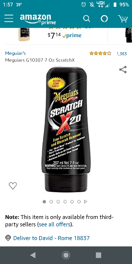

I found this stuff really makes plastic shine. Kind of a happy accident, I was cleaning oxidation off some cases after running them through the USC and got some on the tank. Give it a whirl.
