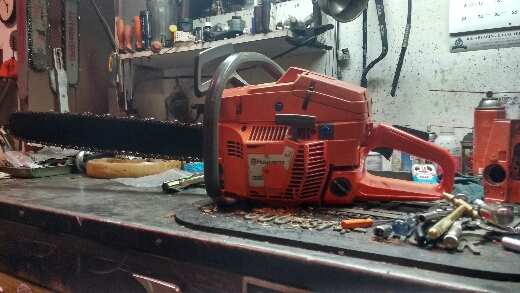

That flywheel side seal might not be deep enough. That seal needs to sit over that crank lip. If you have a caliper you can set the seal about 4mm deep from that lip on the crankcase. Between 4.0 and 4.5 mm is ok.
The seals can catch you off guard on these for sure. I learned the hard way lol.

One eye was puttin together.
Stihl lookin fer nice covers.
Seems healthy tho.

After looking at your saw I'm missing a few pieces on the one here.
My saw also has the 395 style filter on a 394.
Husky illiterate but catching up fast.
Everything looks good so far but the worm gear was melted, it needs a plug wire, the carb box rubber divider and something else

I know you got the short end of the stick on that deal. But hell, it’s a 30-year-old saw. Hard to find them in really nice condition complete. Just throw a bunch of parts at it....I did. There’s a reason they are legendary. Can’t buy one new, Pre EPA Compliant that is....
