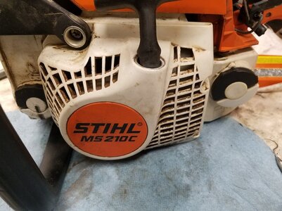

Customer dropped off a MS210C with the "easy start" or whatever Stihl calls their version. The rope would not budge.
I pulled the starter housing off and the mechanism audibly wound up as I pulled it off. The starter rope was so badly wedged in the pulley that I had to dig it out with tools.
Fixed the starter, put it back together, and spun the saw over a few times noticing it was badly flooded with fuel pouring out of the muffler, Then the starter locked up again...
Took the starter off again and noticed the flywheel would only rotate about 330 degrees and stopped pretty firmly near bottom dead center.

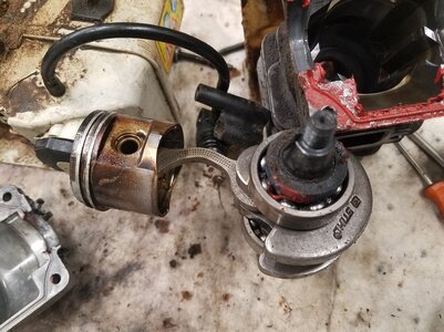

Tore it down further and found this...

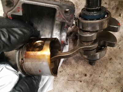

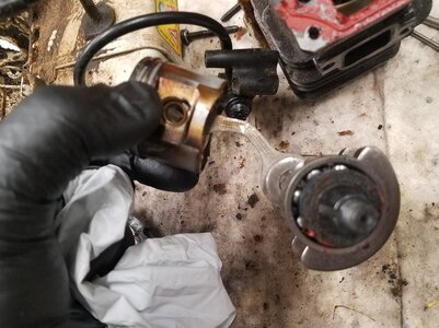

I must assume the carburetor was leaking fuel into the crankcase, a lot of fuel, and when I spun it over enough went through the transfers that the saw hydrolocked and the starter spring and flywheel momentum were enough to bend the rod. Actually I suspect it had hydrolocked previously and that's what caused the starter bind/failure to begin with.
Are there any aftermarket short blocks that work on the MS210? I did a little searching and can find 250's, but it seems they don't just drop in and work with the 210 flywheel and coil set up.
Is this the end of the line for this 210?????
Mark
The 021/210 is one size the 023/not 100% they made a 230 would be a bored 021/210 and the ms 250/025 is a stroked 023/230. I can look tomorrow but I’m sure I have an 021/210 crank assembly for you
singinwoodwackr
2:49 PM
34279
Sep 14, 2025
648
1,908
moon
021, 023, 025 share all but the cyl. Same with 210, 230, 250, I believe
