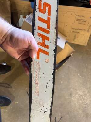

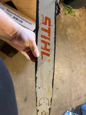

I’ll post photos later but was trying to gauge the age of a Stihl bar I got on auction yesterday. White West Germany made bar with orange writing on it says rollomatic 6 on it and Stihl in bright stihl orange. 20” .404 with a 3002 mount on it.
Kinda different looking

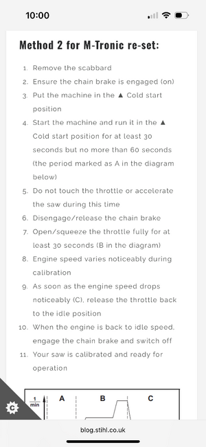

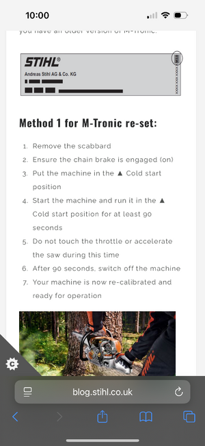

Yes the reset procedure is 30-60 seconds in triangle then hold open and let it tune up and down. Here’s the two procedures and if it won’t run long enough to complete the reset odds are the solenoid kit will fix it. Other thing I had issue with was a plugged screen in carb on one.

Above if you read, method one leaves the chain brake on and lets the saw idle for 90 seconds (without pinning it to high RPM). If you go with method 2, chain brake on for 30 seconds idle, then release chain brake and pin it to full throttle, as it goes through its calibration at some point it will drop in RPMs by itself, then you release the throttle, let it get to idle, set the brake and turn it off. I think that the calibration cycle needs the brake on to set its initial RMP threshold.
