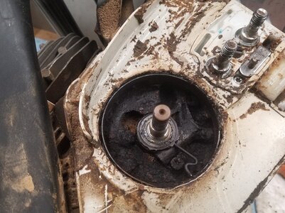

For the few years I worked repairing/selling saws, for the Stihl's that had melted brake housings, it was due to crap getting between the case and the brake band and then with the brake band disengaged, it would still press against the clutch, overheat and melt during use. Saw it a lot with MS 271s.

Most of the overheated ones i have seen the owners have admitted to firing the saw and leaving it on fast idle to "warm up" while they donned thier protective gear 🤣 then "all of a sudden the saw started to smoke profusely".....

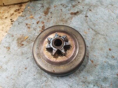

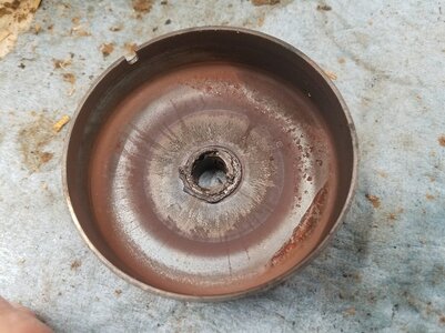

This one came in in February, customer said entirely his fault. He did not read the instructions correctly and left it on high idle with the brake set for several minutes to warm up. Very low hour 291, the clutch itself was overheated to the point the clutch springs were totally slack and the shoes just flopped around.
I kept the clutch in my collection of "Here's and example of what not to do" stuff.
