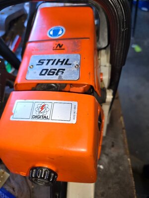

I have one also, bad thing is coils are notorious for failing
You can just use a regular “everything” type Stihl unlimited coil in its place. Just make a little metal bracket for the dogleg mount. Only problem is then the light won’t work…

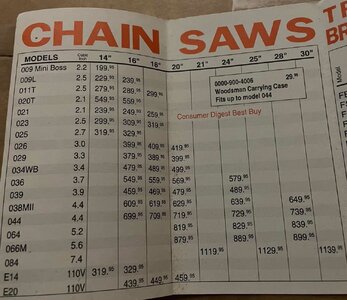

I saw this the other day and wished I still had the option to buy these saws and for the prices listed lol.
1994
Wasn’t long ago the ms 250 was still 329$ of course with the last 3 price hikes it’s now 439 locally. But yes those prices in today’s money but in 1994 400$ for a saw was still a bit of money. Minimum wage was 3.75$/hour small
Business and 4.25$ large business in mn at that time now its basically 16$ an hour.
