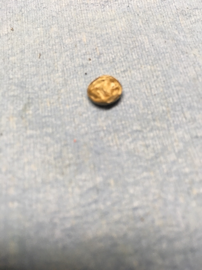

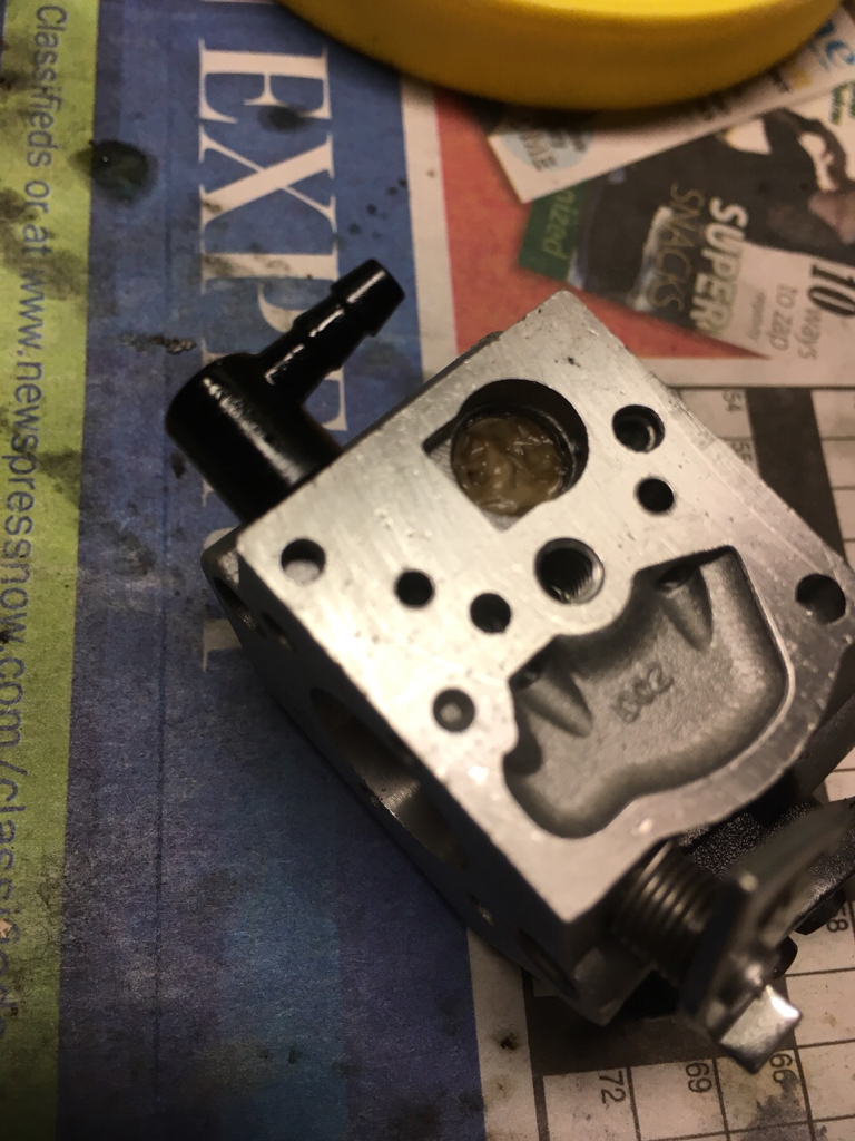

Let’s pay attention to them fuel containers people.
Client brought in an 024 that would only idle.
Blind squirrel found the problem.
Mud(?) clogger the strainer solid.
He had replaced the fuel line and in tank filter too late.
