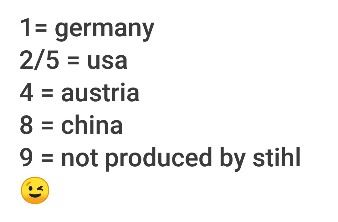

I'd like to know how old the saw is. I've seen the discussion on what information the serial number gives including the country manufactured.
Any idea what 4466522 says about year and country?
RI Chevy
12:53 AM
1254
May 7, 2016
27,002
67,802
earth
4 is from Austria.
nohoff
professional flusher
6:53 AM
4033
Sep 11, 2017
478
2,007
Germany
8 Digits are all Made in Germany. Austria is only lawnmowers and some other Battery stuff
