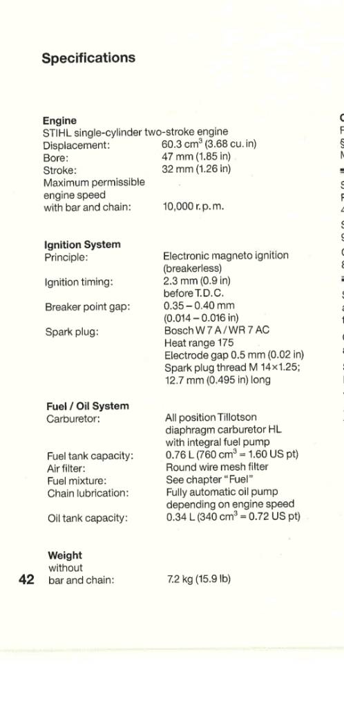

Some specs on the Stihl 08S

08 S - 56cc ?
Powerful saw, tho. There were several utility attachments for it including a post hole auger. The TS-350 chop saw is the same engine and you can still find it in use these days for cutting concrete.

08 S - 56cc ?
Powerful saw, tho. There were several utility attachments for it including a post hole auger. The TS-350 chop saw is the same engine and you can still find it use these days for cutting concrete.
All the 08S engines were updated to a higher displacement and power from serial X 18 735 400 on.
Old version: cylinder with 47mm bore and 56 cm³ (2.5kw)
Newer version: cylinder with 49mm bore and 60 cm³ (2.7kw)
Stroke remained the same with 32mm on both versions. That change was in late 1988 (TI 42.1988)
