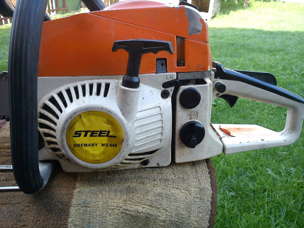

another silly question for the brains trust does the US mod 461R have the hi flow oiler
