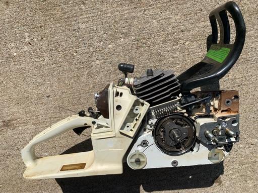

Ya may want to do a vac/pressure test (if you haven't already) to make sure a crank seal leak isn't what scored it up in the first place.
They're notorious for that (as you may already know).
It sure did clean up nice. What sort of initial 'dip' did it get?

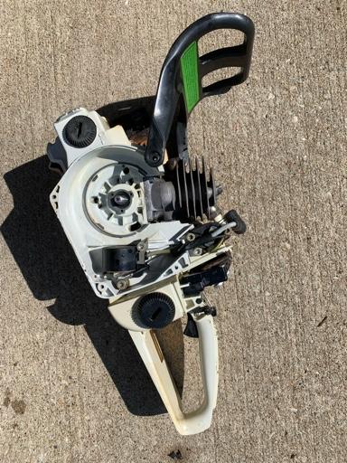

‘The Dip’:
Field strip the carcass. Dig out the saw cake with an old steak knife and stiff brush. Scrub with mineral spirits using a heavy duty parts brush. Give it a couple coats of O’Reilleys foaming engine degreaser. Shoot it into the cavitys. Hose it off with hot water from the laundry room. Mind the muffler outlet! Let it air dry in the sun.
It is important to either finish disassembly or get it running to avoid moisture damage.

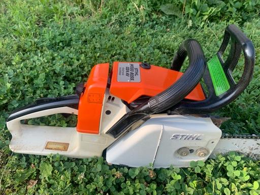

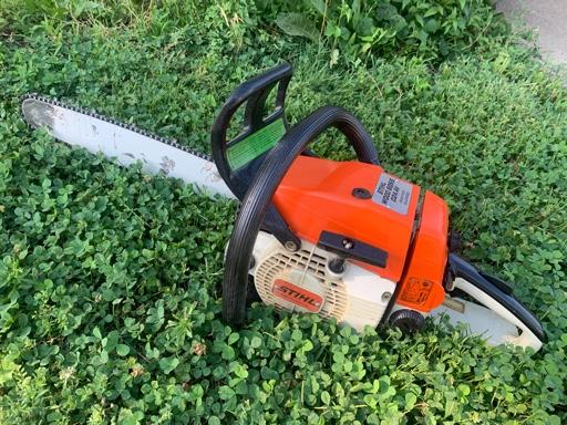

Hell, that's old school, Carl! I was expecting some newfangled magical chemical pressure washer dunk tank treatment or something.
Good for you, brother. Looks great.
Washed the gingerbread parts in mineral spirits.
Whitewall tire cleaner works good on a sap covered clutch cover.
Are we anal, or what? [emoji2960]
Little twerp runs good. [emoji106]

Real good looking saw though, good job. My 036 is slowly becoming my favorite saw to use in my day to day. Used to be my 044 but since I moved to Colorado from Washington I'm finding it a bit more than is needed.
