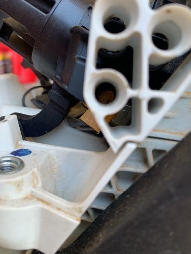

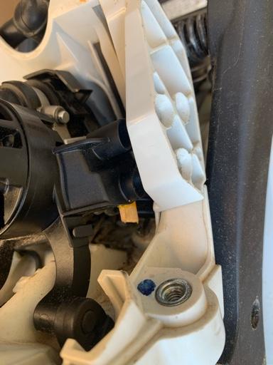

Real head scratcher:
I’ve had this MS311 for about two years now.
I’ve been chasing a idle speed problem since I got it back together. Won’t hold a steady speed from one cut to the next. Keeps increasing. Which gives an impression it’s got a vacuum leak.
Close inspection revealed the idle speed screw has been turning itself IN (!). [emoji90]
Most screws vibrate themselves out! WTF !
Reset the idle and use the end of a popsicle stick and a dollop of 3M weatherstrip adhesive to lock it in place.
Left enuf sticking out for removal
