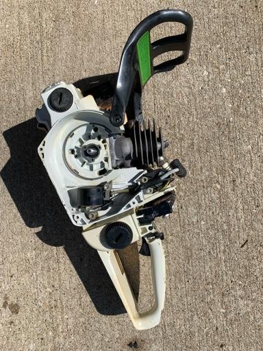

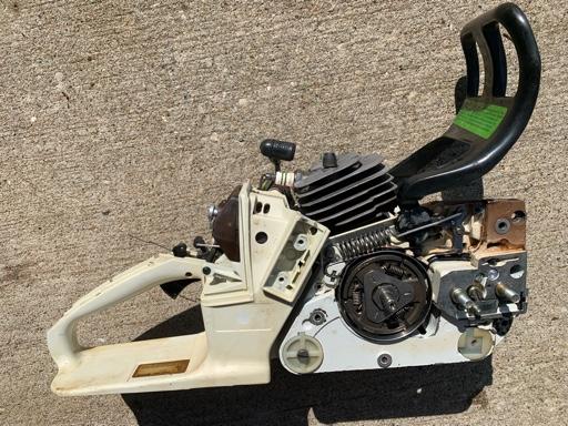

Took an 024 in partial trade. Scored top end.
Gave it ‘The Dip’.
Can I slap a MS260 top end on there or will there be a problem with the cover plastic?

Unless it’s a 024 super the 026 is a longer stroke, the 024 is one stroke length then the super is same bore and longer stroke, finally the 026 is a bored out 024 super basically.

i have a 024/6 conversion
plastic under tag cut out makes nuff room
friend did it, not me
dunno if any diff bet 026 & 260 tho
