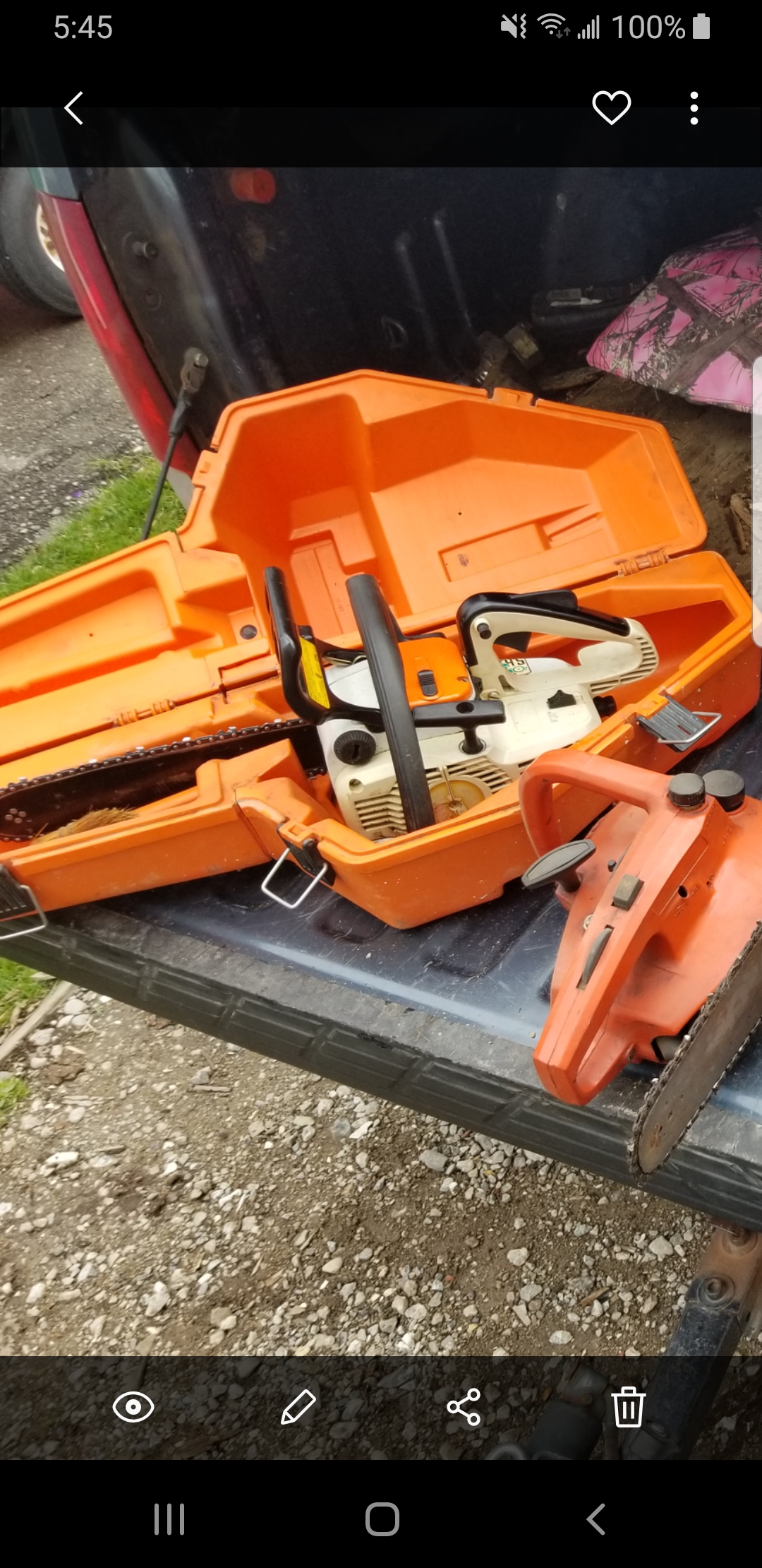

Pretty much everything on this 009 is in great shape, one would almost say minty. I'm going to tear off the cylinder and have a look. If the crank and cylinder look fine then I'll probably just fix it. The only thing I appear to be missing is the handle molding. Like previously mentioned it could make for a good camp saw. Honestly I could use it around the place for pruning the fruit trees. However, i'm in a little hot water with the wife for bringing in too many saws recently so I'll probably just sell it. Probably going to sell my 056 super w/ mag II Top End as well. Yeah....that's how much doo doo I'm in.
