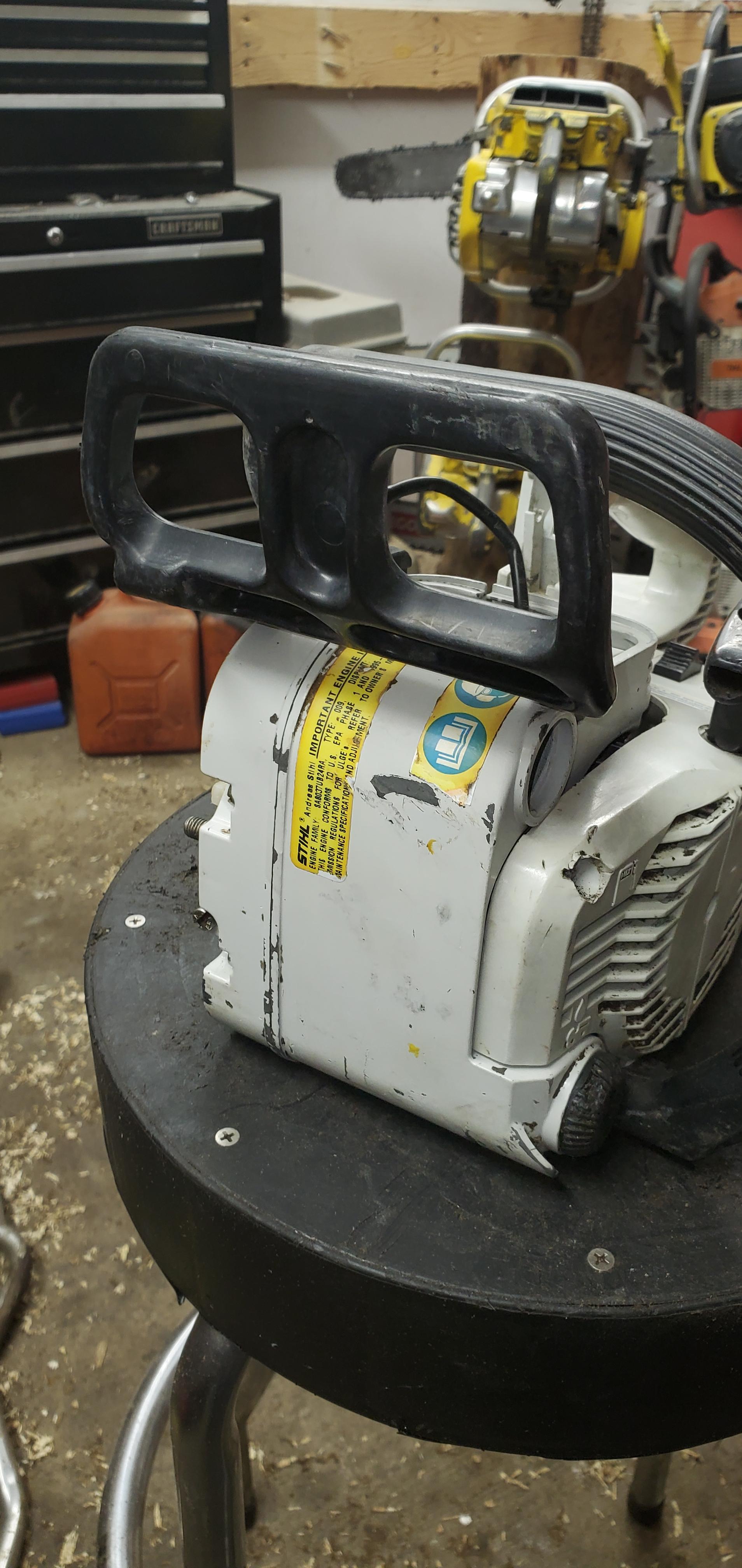

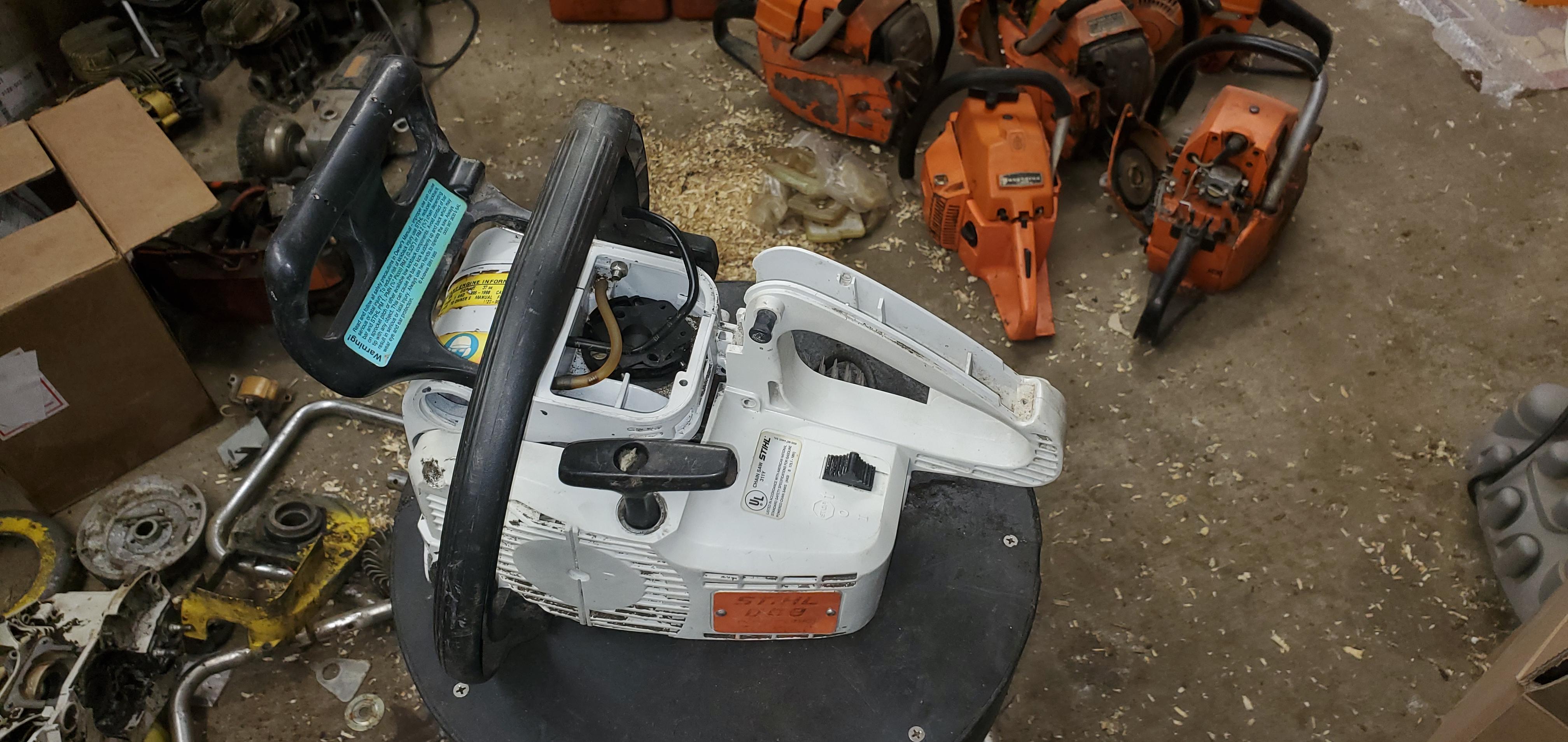

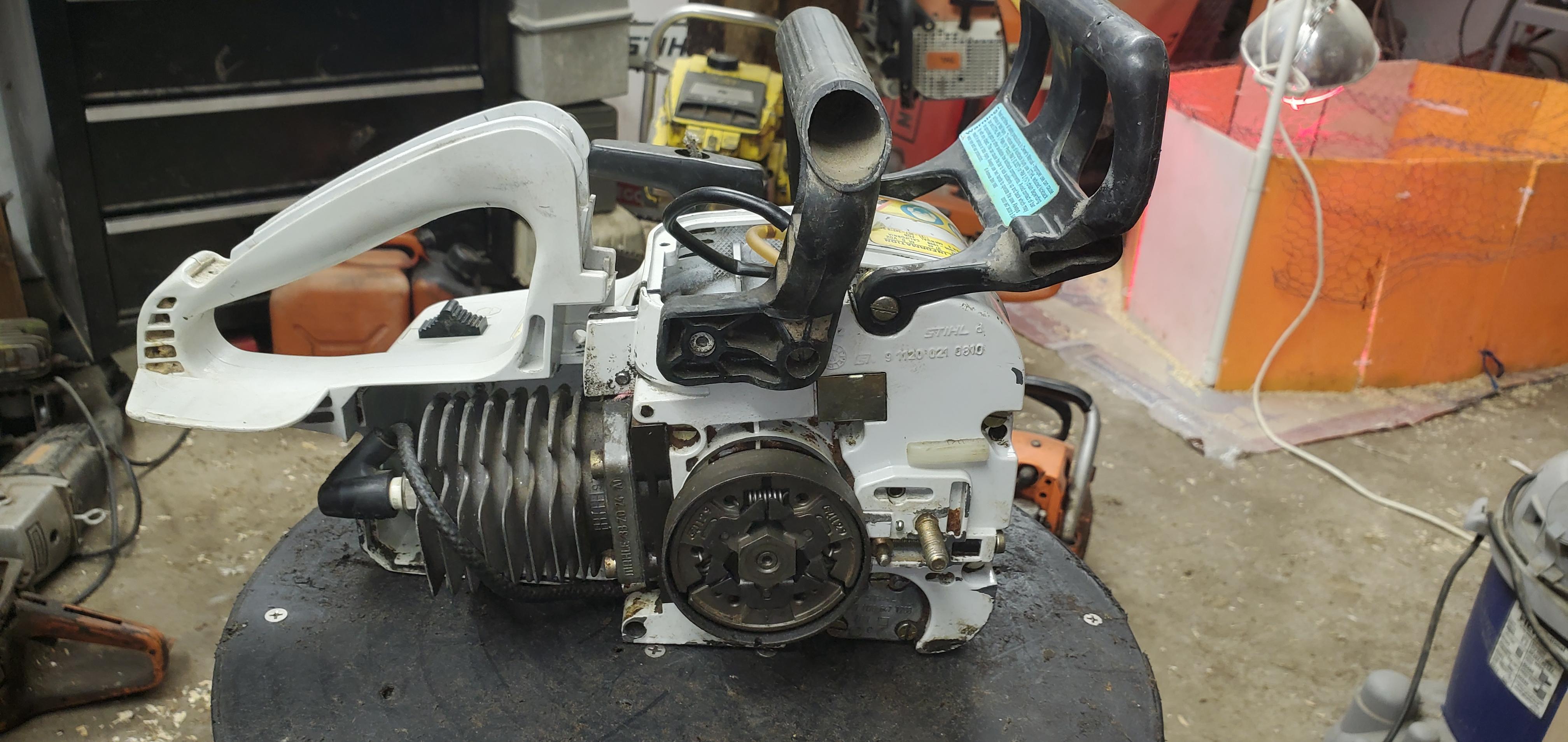

Hey folks. I've got a little 009 here that I'm thinking about fixing up but I'm trying to decide if it's worth my time. What would you folks say a low hours 009 in mostly original condition aside from a new oem piston is worth?

Actually pretty cool little reed saws. But whatever time you're willing to put into it is about all one is worth. The good news is there are plenty of parts donors for those saws. With the exception of top ends, 009 ~ 012 saws share lots of parts. Here's a quick and dirty Clymer rundown. I also have the Stihl IPLs and Shop Manuals if you get serious.

And if you are real serious I have a mostly complete 011 I believe that would be a good donor. Can send you pics sometime if needed. Thx

Everything is original and seems to be in great shape! Carb is currently set aside. I found some fair scoring on the exhaust side of piston though. Even the air filter looks fairly new. I've got the trigger, interlock and spring set aside but I'm not sure where the handle molding went to.
