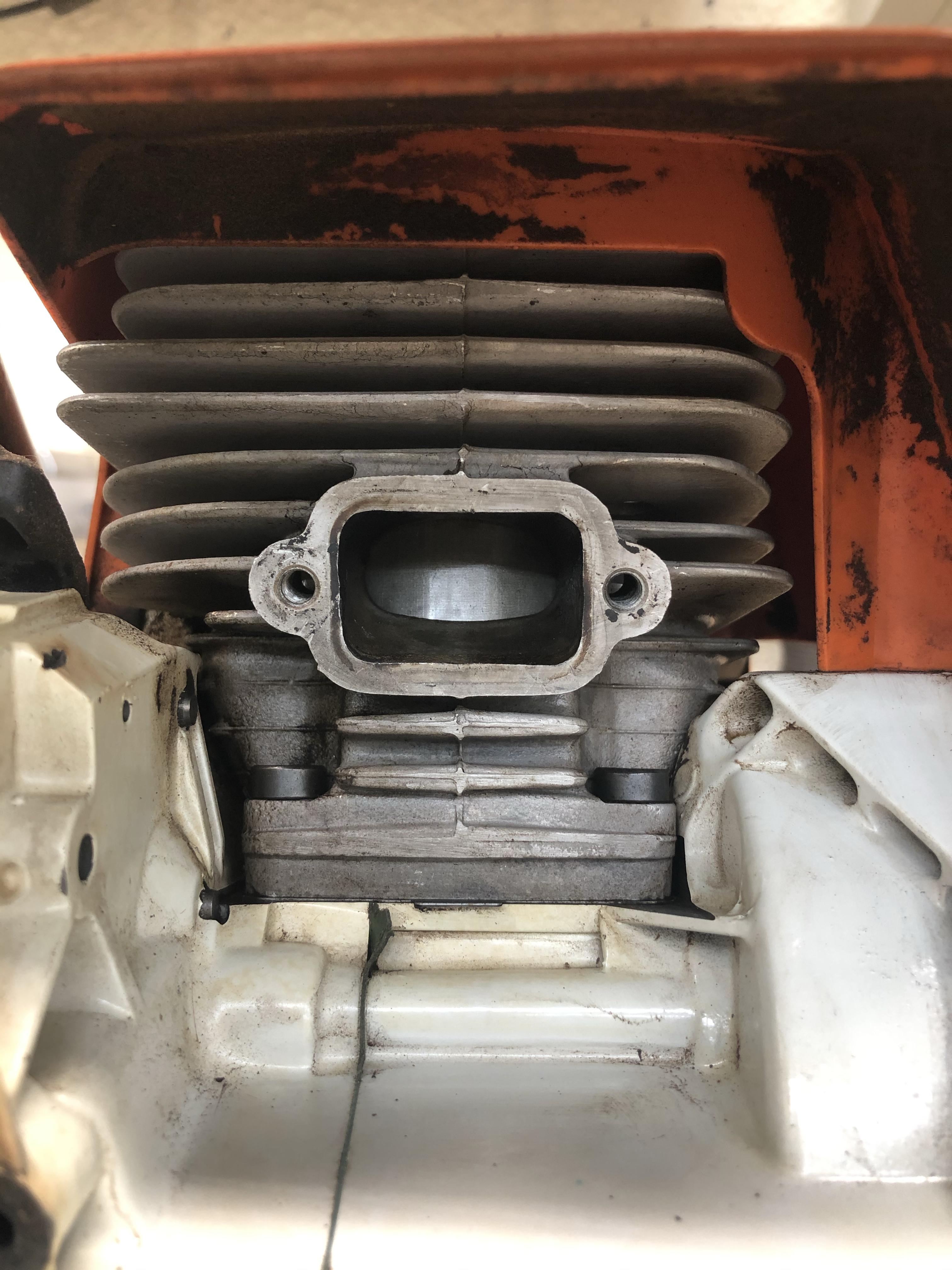

F445E6F0-FDF9-46AA-81C5-F05C6F2E0393.jpeg 13EA0581-8B86-44CC-A327-A11EC9B07E27.jpeg A393F2D7-E24E-4EA8-B494-726D1F30EE35.jpeg Guy gave me this for cutting a few holes in the ice so he could jack up his boathouse. It’s blown up but I’m certain the cylinder will be just fine. Way it smells old gas got it but obliviously I’ll give it a good go over when putting new piston in

Back in the old days we asked ridiculously rich fuel mixes to be the safeguard against friction and heat related damage..., at less RPM's in designs with much greater mass for heat dissipation and a much greater degree of forgiveness for poor operating conditions and shoddy (if any) maintenance. Debris ingestion was pretty much normal.
These days we ask electronic control modules to do the protective and optimization stuff at 14,000 RPMs totally dependent on the air/fuel/RPM relationship being controlled by a very fast counting technology..., prone to incorrect adjustments and learned performance compensation from lousy fuel, lousy mix oil, clogged air filters, and debris ingestion from both the air intake and the fuel system. And that doesn't even include operator abuse by those who fail to understand the actual complexity of today's chainsaw technology..., which is actually quite frail compared to designs of just 20 or so years ago.
Lots of smoke no longer represents that wonderful 2 stroke safety net of days gone by.
Today it means your saw just said goodbye.
I agree that the digital controls are definitely more sensitive to debris and fuel quality, and that would certainly cause some tuning dilemmas for the ecu . Which I think would shut the saw down but I think what the face book post was implying was that the piston and cylinder are toast because of bad filtration.

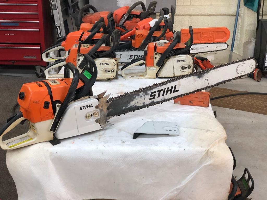

I scored a nice MS660 the other day. Cleaning it up now and inspecting it. All original and piston looks good. Pretty clean saw so far. It’s a dang beast with that 36” bar on it though!

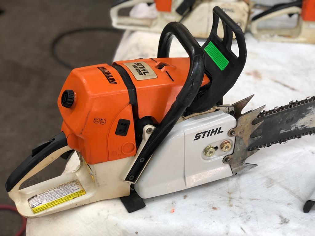

Repainted the recoil and clutch cover. . Cleaned up pretty nice.
