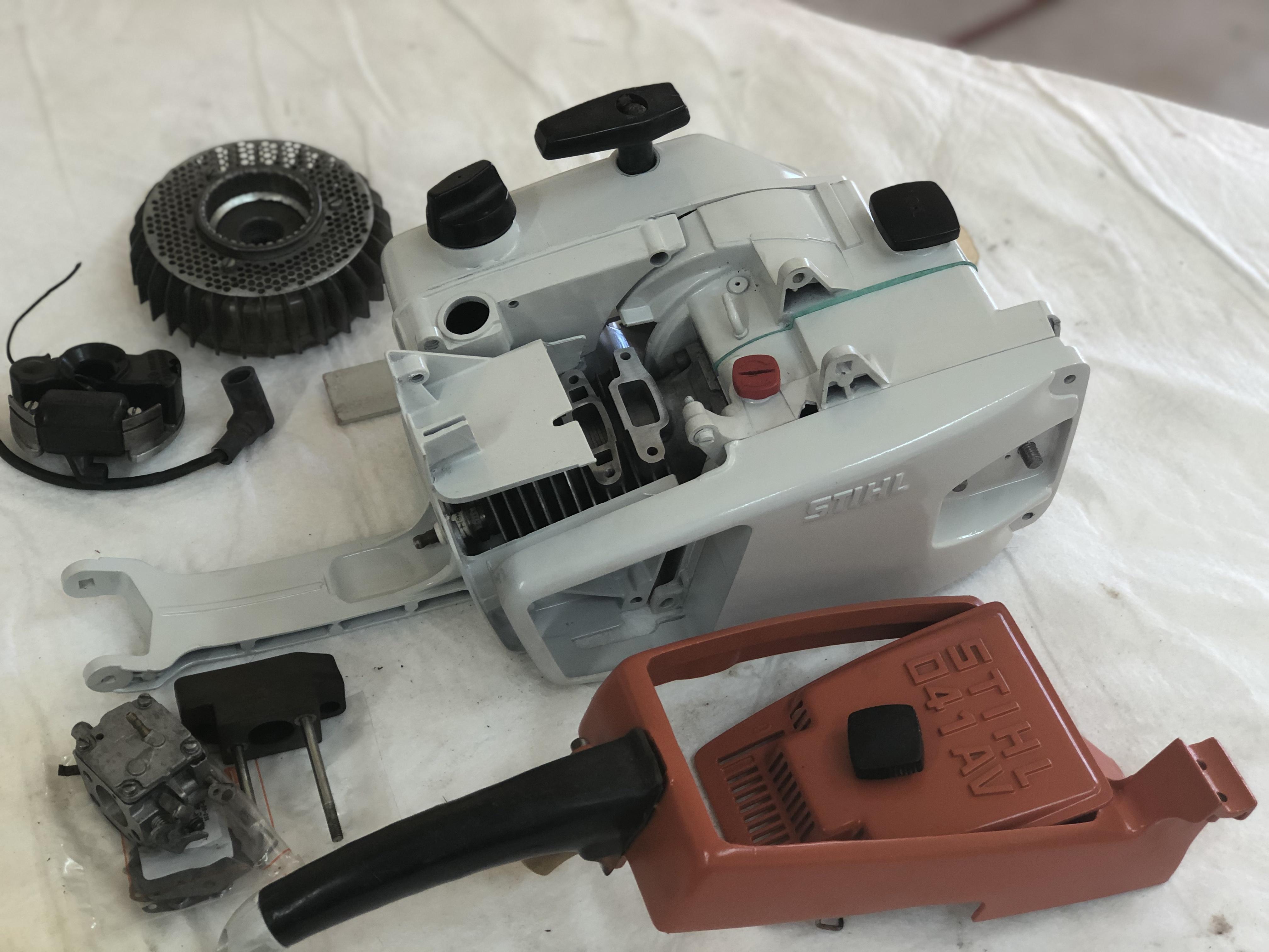

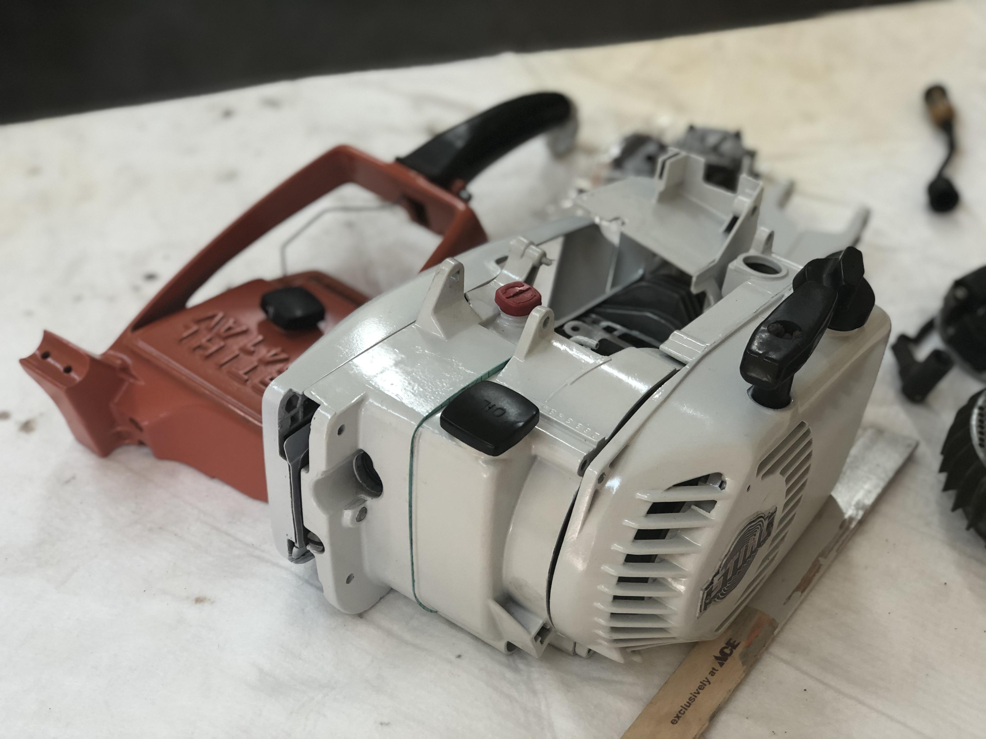

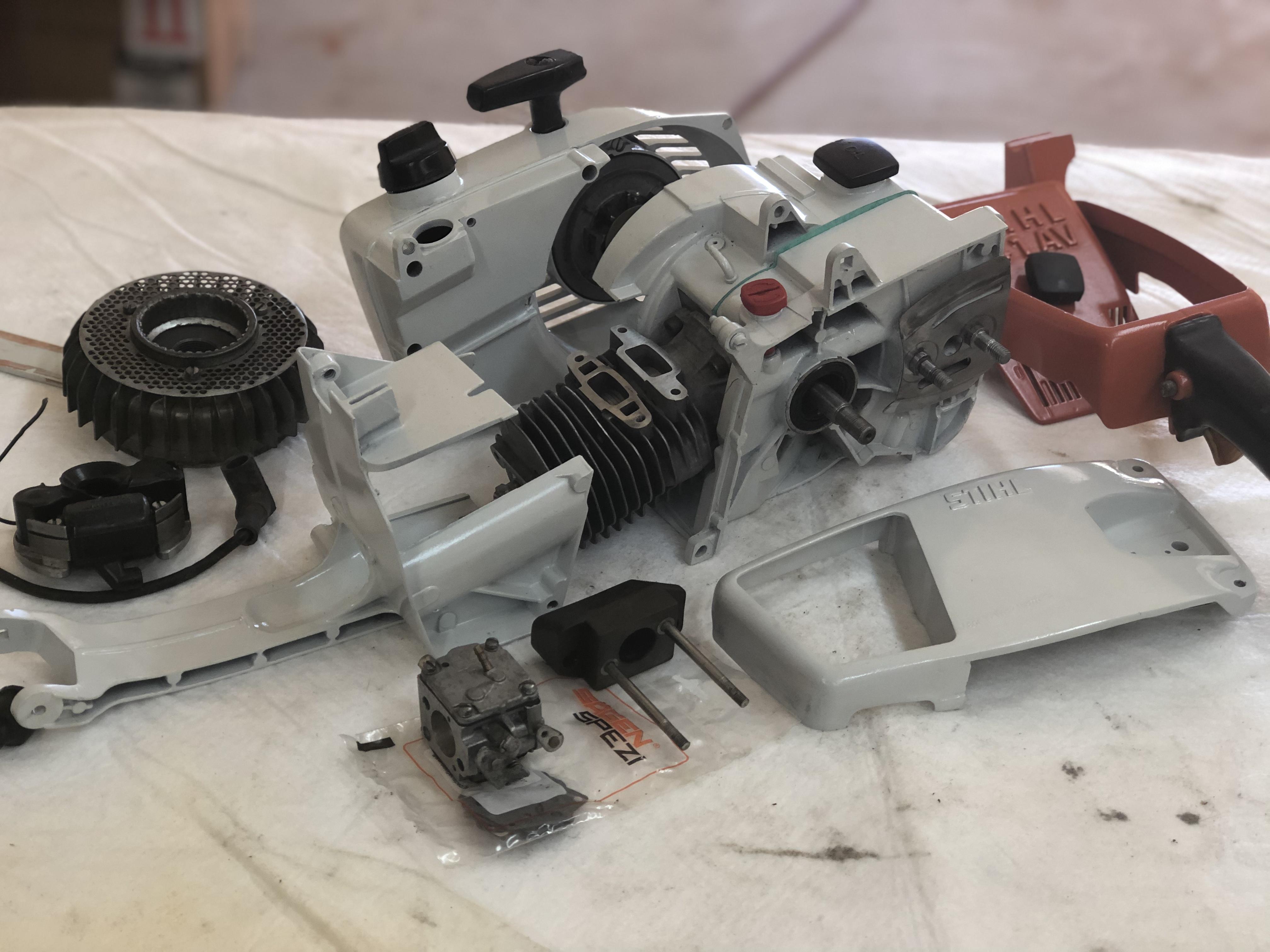

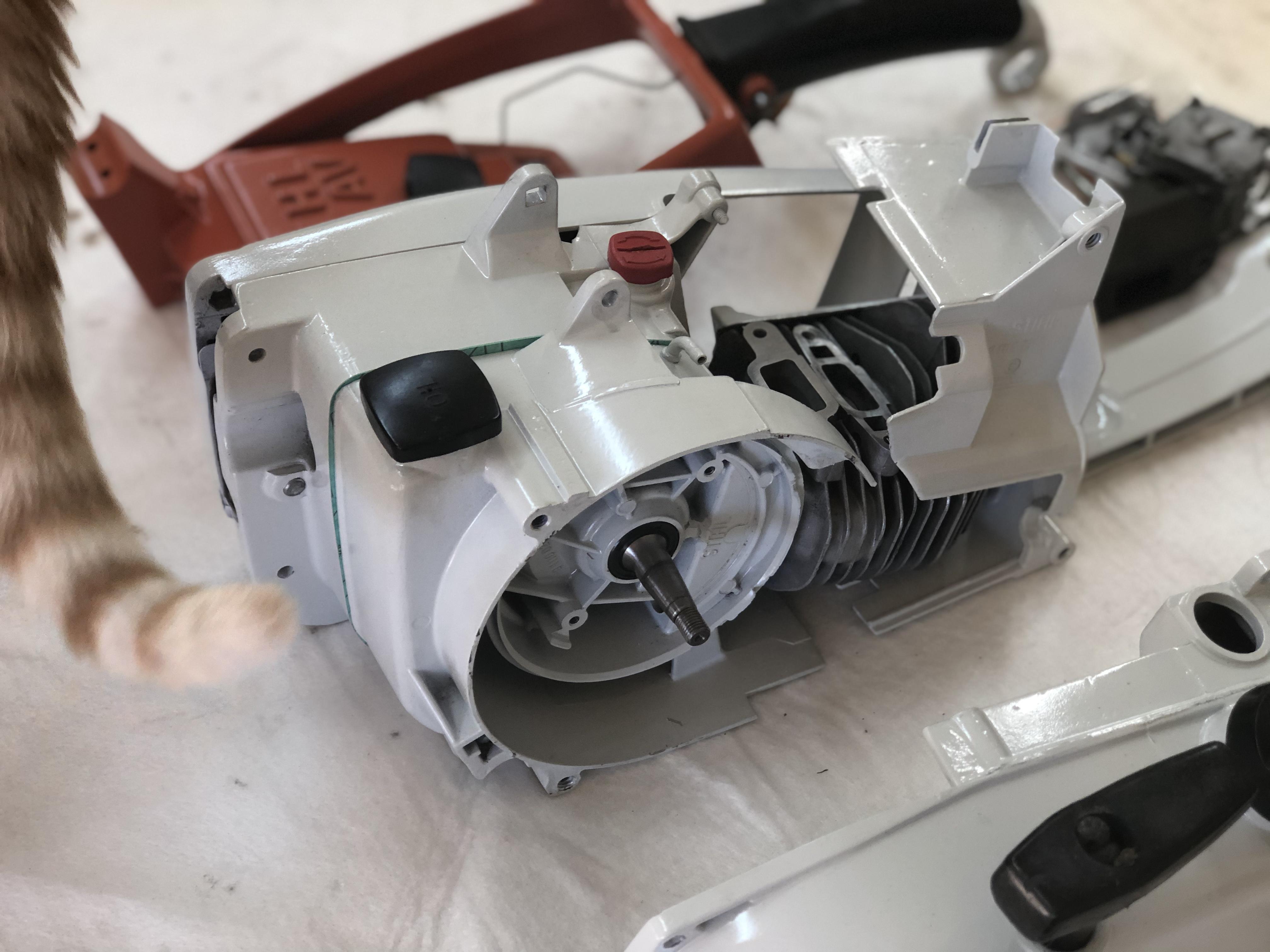

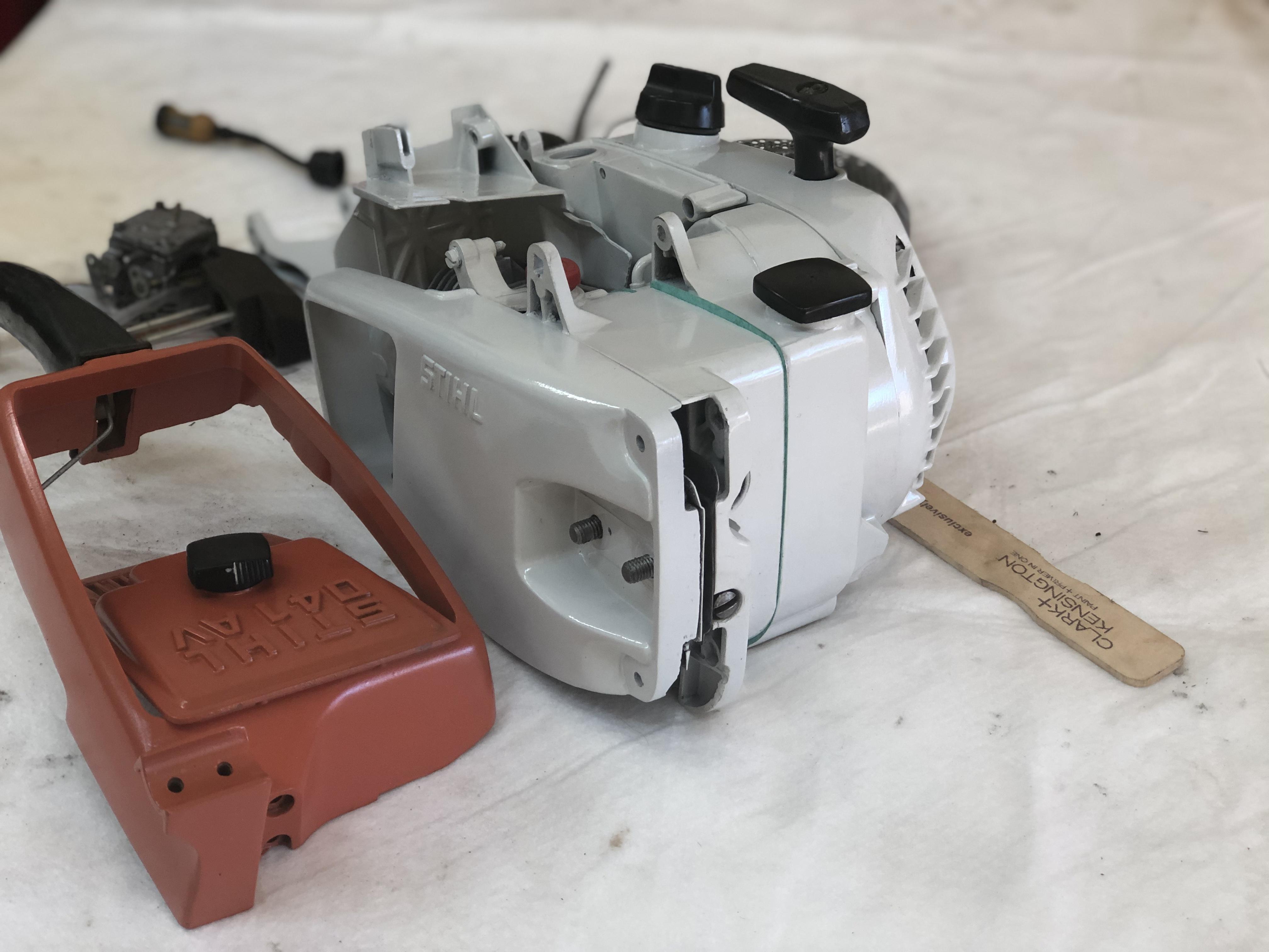

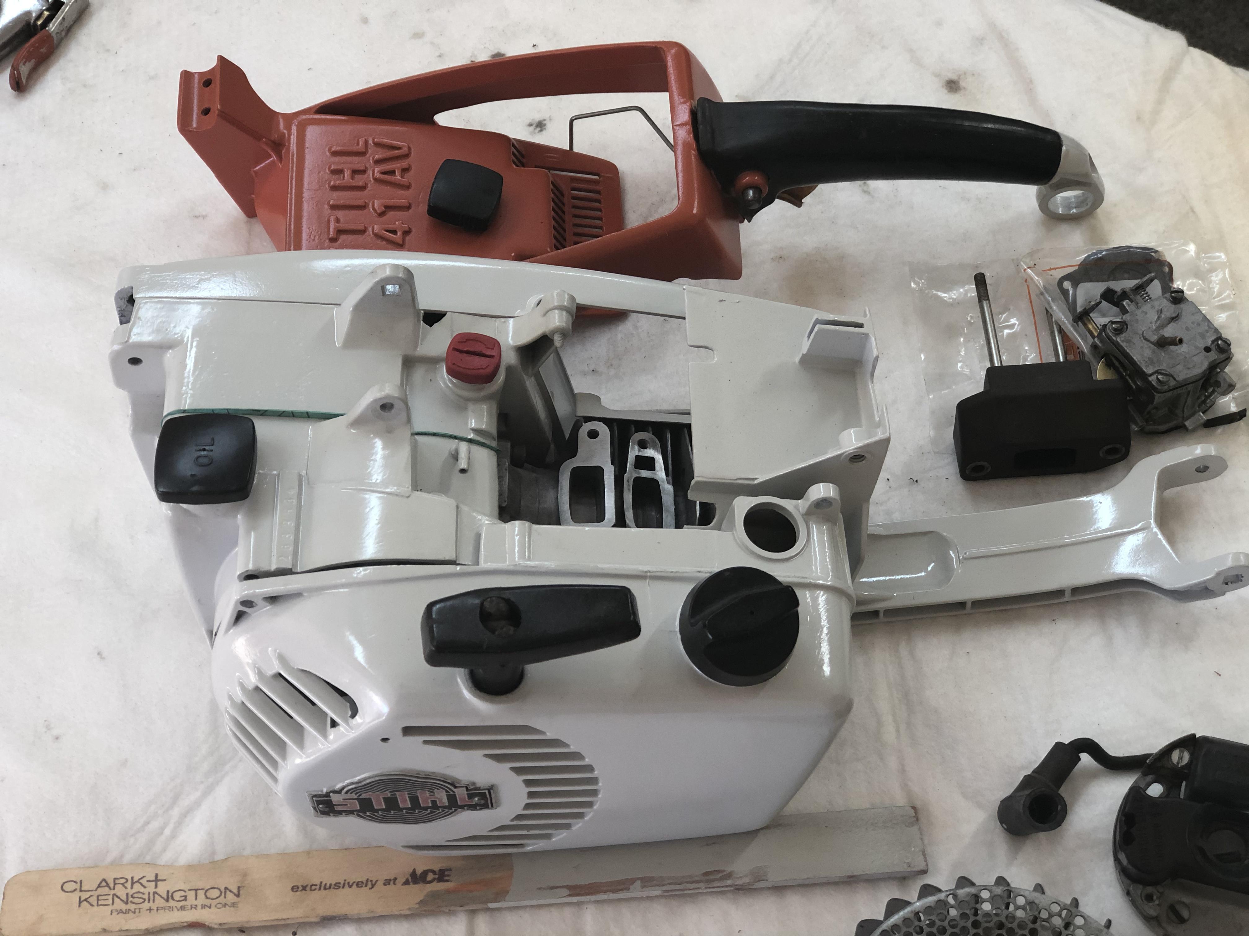

Update on the 041 AV restoration
98afe9a784dbbe6715c9dea383be2945.plist
63c510987c4f19450331f394bd8d1ce5.plist
0c44c3b863aa028043f5feff08c36a9e.plist
8890530ea1d7ee53dba37525567784b8.plist
5fcafbb02459a8ebbe6978e2fa16134f.plist
OGStihl
6:12 PM
15661
Feb 7, 2021
75
157
Harrah
Got the case together with the new OEM bearings and gaskets. Original cylinder and piston with new rings. Decided to go back with points ignition. Should finish up this week and post it.

Looks good. Pay close attention to the oil pump and oil adjuster 'O' rings for good fitment. A vac/pres test would be a good idea if you have the means. Those particular locations are prone to air leaks and can drive you nuts if you're failing a vac/pressure test and can't figure out where.
