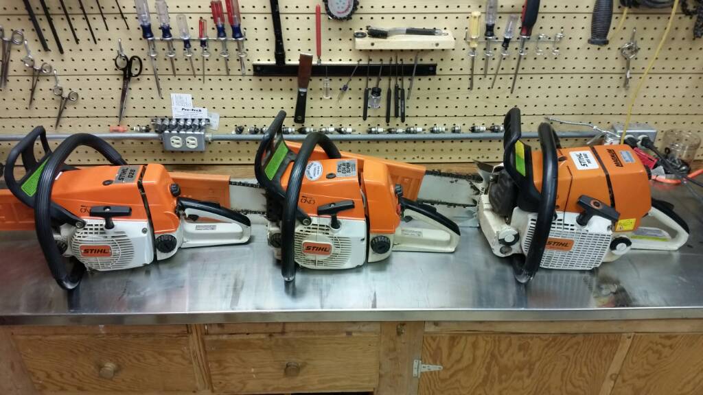

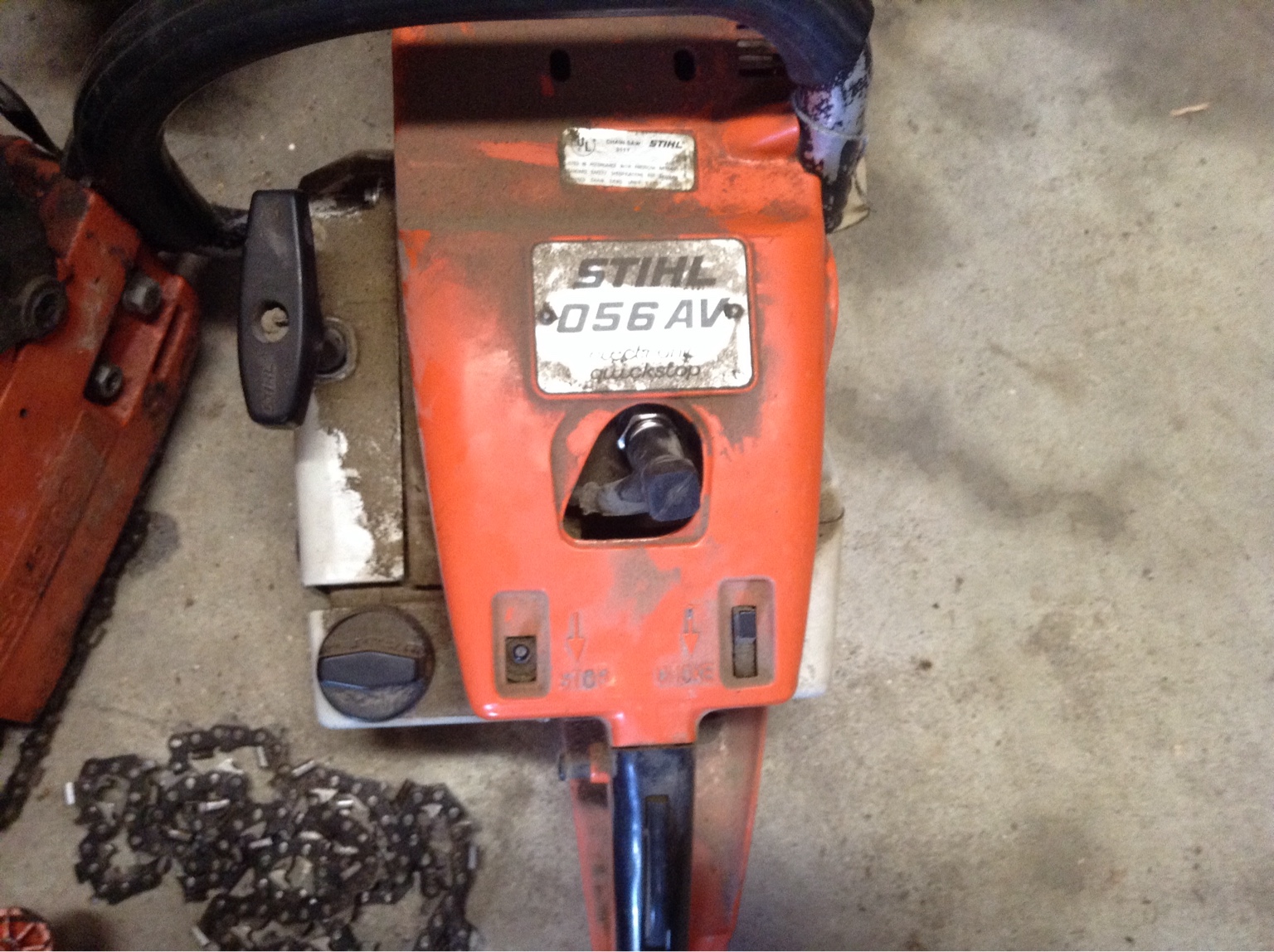

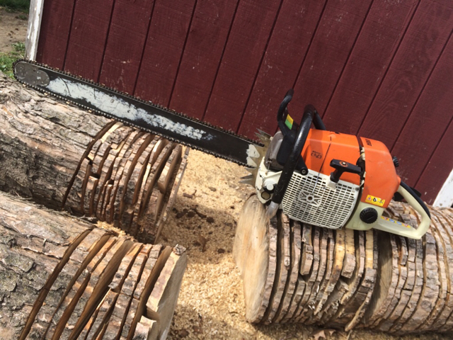

Here is a few of my saws.
038 Super needs work.
041 av runner
032 needs work
660 works
028 super works
have another 028 super
older 028
044 i assembled from a few carcasses. new oem bearings, seals, intake boot, impule line, dual port muffler. I built this saw with 12mm case halves, 10mm crank, 10mm piston, 12mm cylinder. Runs great. Next i will remove cylinder base gasket for tighter squish.
Ill have to take some more photos

I love the organizational skills! OCD is a wonderful thing...
