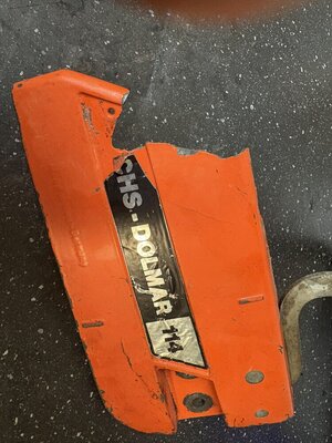

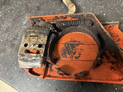

I would like to get a brake/cover eventually, this one is missing the brake band, not sure what else until I clean it up.
Good thing is you can get the 120si style 1 piece ignitions that work perfect can even get rid of the junk under the flywheel. There is even aftermarket ones now. Brake bands can be found aftermarket now too without the lever but looks like it is still there. Can't believe there is no clutch covers on eBay at all though
