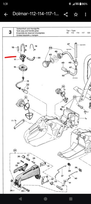

Got a nice condition Sachs-Dolmar 114 that I’d like to refresh. I can already see finding parts is challenging. Fortunately most of the parts are in good shape sans a few foam pieces.
Is there any fuel line mods or other part numbers that would work on this series (112/114/117/120)? I was looking at the possibly using a line from a PS-341 but can’t verify the grommet dimension. Hole on the 114 tank is about 13mm.

You need one of these then it is just regular fuel line Screenshot_20251120-133143~2.png

You need one of these then it is just regular fuel line View attachment 475333
Yes sir the one I have on the saw has shrunken and doesn’t fit the hole snug. I thought about putting an o-ring on it.
Haven’t come across one in my online searches so far.
Also had the idea of using a 2 hole rubber grommet if I could find the size

You could wrap a piece of Teflon tape around it I have done that on fuel lines before. I have also put a dab of super glue on them before. I probably have some of those let me look and see if I have one that is better.

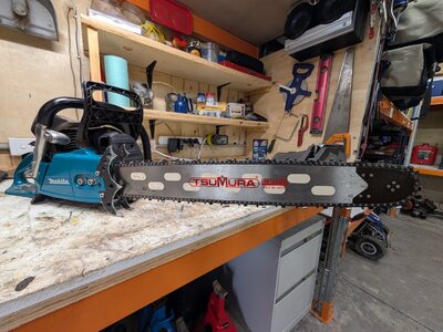

What bar mount is the ea6100p ?
I'm having trouble with the oil hole on the E-00153 E8 bar being higher then the oil port on the saw.
I also read that a D009 mount should work on these saws but the adjuster doesn't line up with the hole on the bar.
Thanks very much

EA6100/PS-6100 is small Husqvarna mount, aka k095.
Large mount Husqvarna, aka D009 won't work on them!
