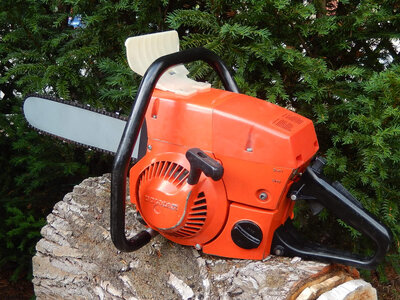

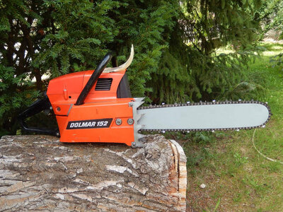

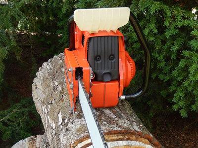

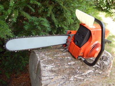

I finished reviewing my recently acquired DOLMAR 152.
Piston was severely dented so I had to replace it with a new GOLF piston.
Few more gaskets, carb diaphragms, a bit of cleaning and there she is:
fertig_hinten_links.jpegfertig_rechts.jpegfertig_vorn_links.jpegfertig_vorn_rechts.jpeg
Unfortunately the ignition (a Bosch KDT-type electronic ignition) doesn't work and gives no sparks.
After measuring the transformer and seeing reasonable resistance values, I tried the fix Jim described
but with no success. Still the ignition doesn't fire.
Seems like a have to look for a replacement ignition...

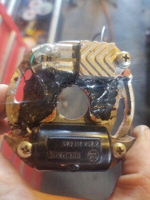

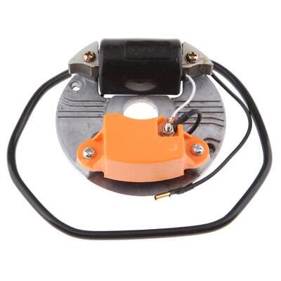

As a last ditch effort could use point conversion transistor chip. Then either slot the holes a lot or use point flywheel. Here is one I did that the capacitor didn't fixIMG_20220403_120731062.jpg

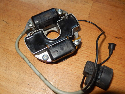

A german collector sent me a used ignition harvested from another DOLMAR 152.
It has the same Bosch-number than the faulty one built into my saw.
Built in the "new" one today and it gives me strong sparks!
Tried to start the saw and BINGO — starts and runs fine :ARMS1:

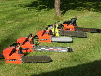

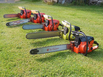

Now that my 152 is running, I carried my other members of the DOLMAR 144 family of saws into the garden to join for some family-snapshots:
Bottom pic, front to back:
SACHS-DOLMAR 153 (the 144 line's final development step)
POULAN 6000 (a DOLMAR 152 in disguise)
DOLMAR 152 (my recent acquaintance, a very early specimen and except displacement very similar to...)
DOLMAR 144 A (2 of them, the revised and improved 2nd version of DOLMAR 144)
What's still missing in my collection: Early 144 and late 152.
For now I'm very happy with this bunch of beauties, all of the are runners and some have been shown at GTGs.

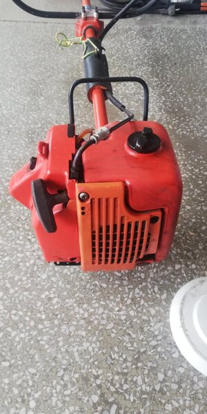

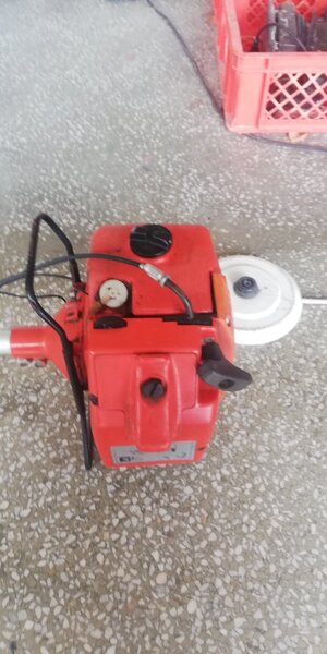

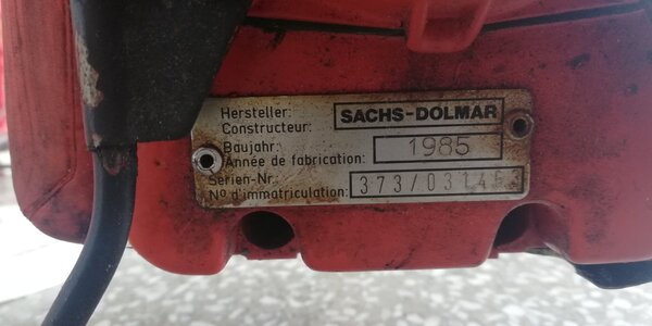

Bc 330 😎👍trimmer For colder days 😉 because it has operator heating 🤠
