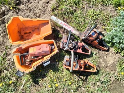

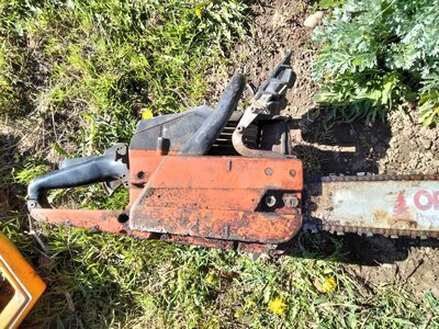

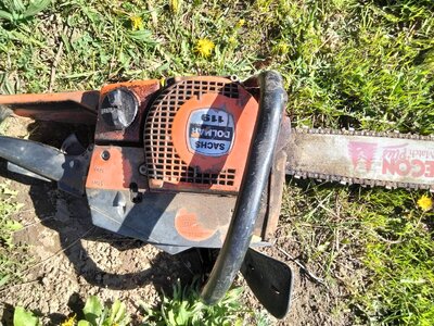

@Wilhelm , I finally got my first Dolmar! It is grimy and has some external rust and case rot, but once I got the recoil cover off (needs new pull rope and handle), the flywheel rotated without issue. It had a brand new spark plug in it, so I am assuming possibly carb issue. No marks on the piston from what I can see, so quite excited to get it cleaned up and running!

119 is an awesome saw. Almost identical to the 120 basically a different fuel tank and case shape right by the gas cap

I am quite excited about this saw, don't know anything about it other than it is around the 60cc range.
Yes 61cc super simple saws check piston and cylinder, crank seals and intake block. Only downside is the ignitions go bad and loose spark especially when hot
