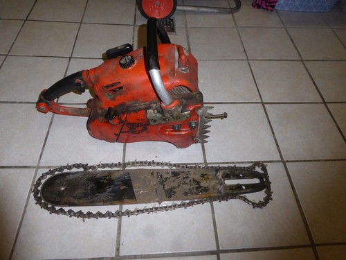

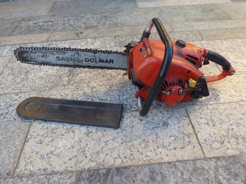

@old_sir_henry , Do you have one of these in your collection? I saw this listing and thought of you. It's not too far from you either. He has more than just these for sale.

@powerstroke cowboy :
I have a CA 113/3 (with AV rear handle, similar to the items you linked to)
and would perhaps look for the older models.
I'm watching the ads of this particular seller and probably wouldn't buy from hin since he
has IMHO some questionable habits:
First he claims to be a private seller and therefor dodges any customer rights a profesional
seller must obey: He refuses returns as well as any kind of warranties, but he permanently
has between 150 and 250 different ads online, which IMHO shows him to be a professional
seller.
Second he repeatedly inlcudes passages of this page in his ads https://wiki.motorsaegen-portal.de/wiki/Technische_Daten_Dolmar_Motorsägen
without even bothering to name the source but instead claims "I have found out...".
No he didn't find out anything by himself but rather copies other people's work (among others: mine).
These are practises I don't tolerate on a seller and that's why I wouldn't buy from him

@old_sir_henry .
Gotcha. I can't read German. Wish I could. I never bothered translating his adds so I could read them. But I did notice he cited some of your work. But did not know he did not give credit where credit was due.
I don't blame you for being leary. A guy's got to be careful. Sounds like you have quite the collection. Sounds like.the safest way would be to do the transaction in person.

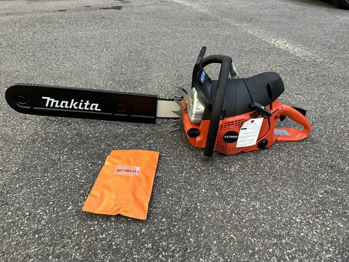

Somebody else out there thinks a bunch of Dolmars.
Yup. I've been watching that one. A new Makita DCS7901 sold for 1325 on ebay.
