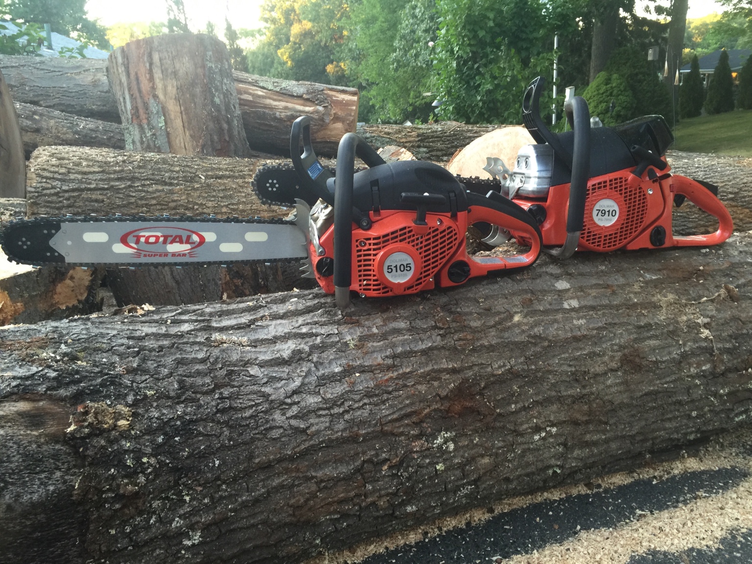

Finally got a load of logs dropped off in my driveway. Got to take out the 5105 and the 7910 for the first time. The 5105 is a great saw! I was surprised by the power it has. The 7910 was nice too, as expected. I have more sawin' to do tonight.
