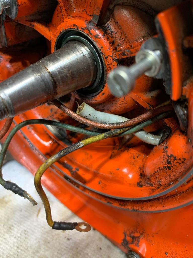

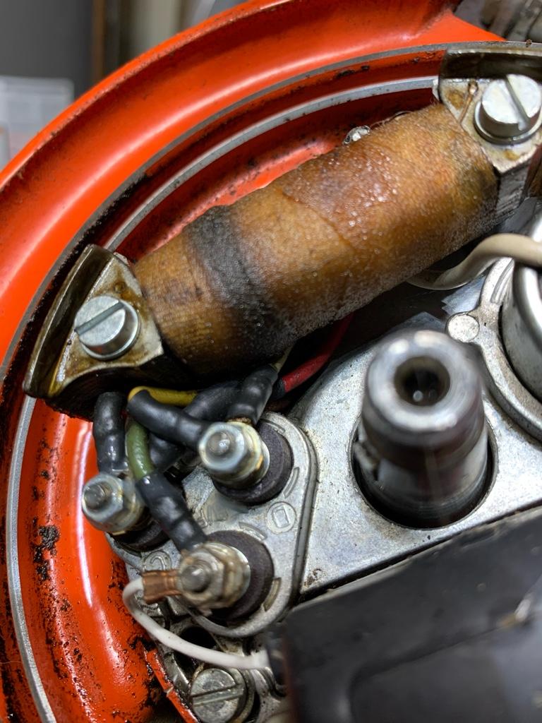

I’ve had an ongoing problem with my big CT in that it would start easily but then run erratically. Tried various things over a couple of years and then let it sit for awhile until a new idea and spare time came up. Figured it was ignition when the tachometer would only read half speed when it acted up.
Two coils and an isolated kill switch seemed to work for a short time.
I then learned that the ignition from an 070 was essentially the same and I could get a cheap clone to try. So I put that on and it ran but couldn’t get the timing right. While pulling out the trigger unit I found the problem.
Fixed this and back together again but still wouldn’t run past 3400rpm.
Next learned that the older ignition from a CX had points and would fit. A year later I put that in using timing marks from the CD ignition. The old girl started on the second pull and doesn’t miss a lick at any speed.
I may have to retard the timing a little as it has a kick back habit when starting. But it runs!
