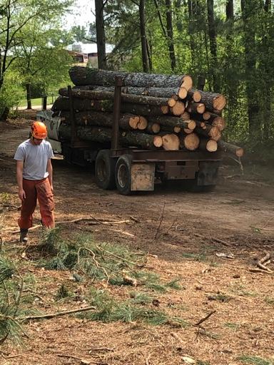

1 messily old Stihl 461R cut that load one morning.

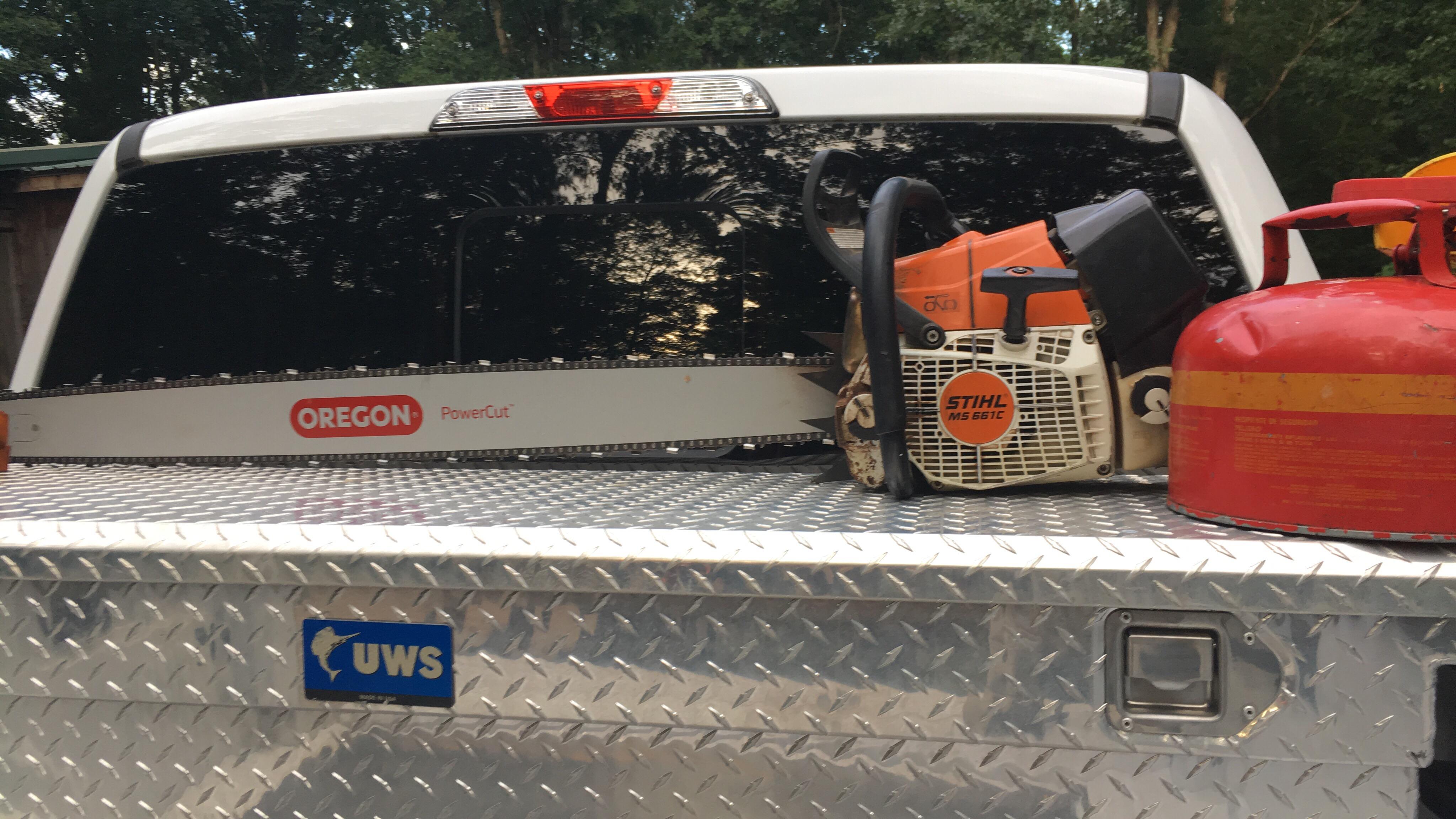

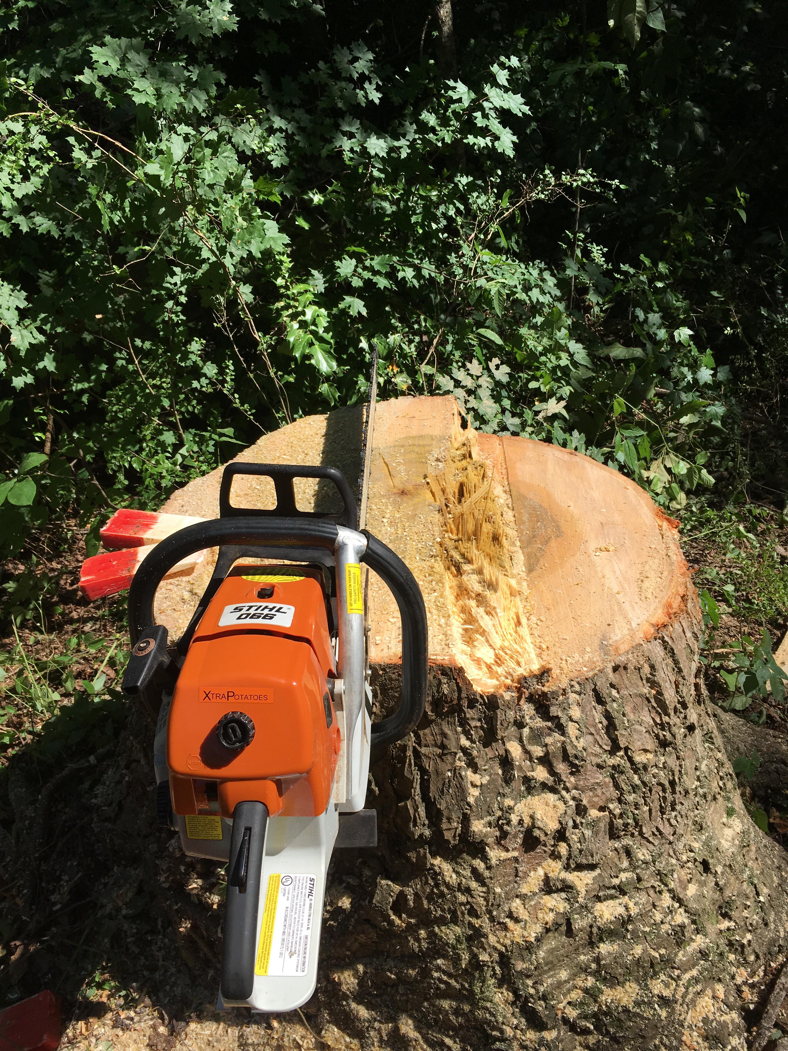

I don’t know that I’ve got enough crayons to explain this for you but I’ll do my best with what limited resources I have to work with.
I’m Familiar with the 2nd best selling German Saw Brand, now the 2nd best selling Japanese saw brand. If they had been supported here I would have some Dollys. But they don’t, & I’m not going to run Hushees if I can help it.
The 066s & 661 I’ve had has more stones than the 9010 so I’ve kept at least one of them 66s all along.
But as I was saying,
A 90cc saw with a short bar is counterproductive.
You’ve got some nice saws.
