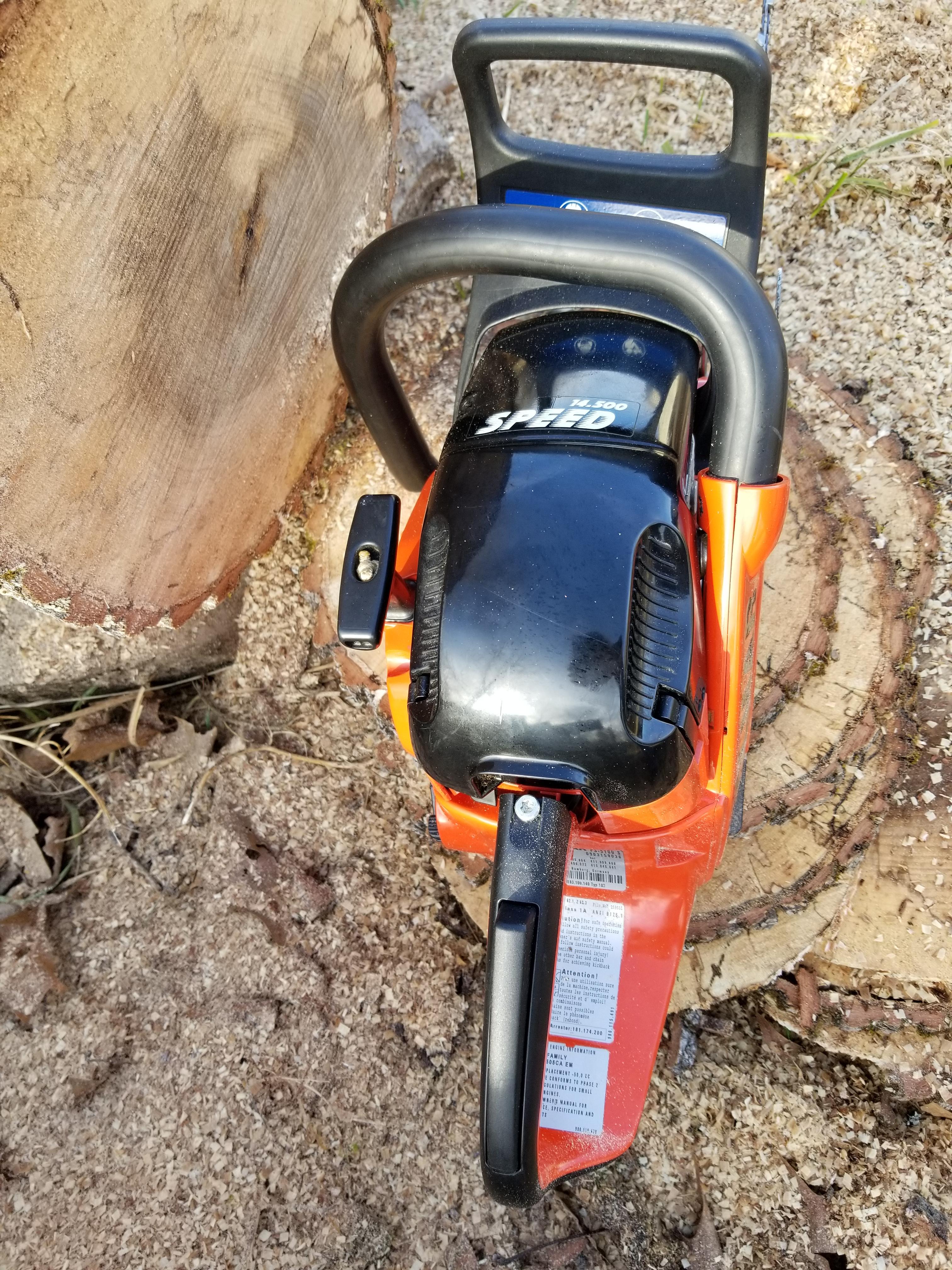

First time into a PS-5100... Owner was having a hot start issue so I went through my usual service but am suspecting coil.
Anywho, after a much-needed carb rebuild and the usual, she’s a runner. Setting the max rpms is easy as it’s responding well. But... I don’t trust the rpms this thing appears to spin. I read on AS that 14000ish is “factory.” Yikes! Does anyone have any comment on that? Longevity of these saws seem ok at those rpms?
Knowing this guy, Ill set it at 13500 w a good 4-stroke and leave it.
Now to get this thing hot and check spark...
Hey buddy...It has limited coil I know that. What color is the coil? My 5100 has the white and says 14,500 on the shroud. I am not sure what the other coils are limited to?
The newer red replacement coil is 13,500. Has a different timing curve than the white one too. Supposedly the saws run a little better with the red one, but I’ve never tried or had the chance to compare the two. No 5100S here, unfortunately.

Hey man!
Yep, limited white/grey coil. Unlike my beloved 1125s, this saw has a broad “good” range on the high side. It sounds good from 12800-14000 almost. I need to tune it in wood but definitely want to err on the rich side.
I was curious about how well bearings and other bottom end parts are handling the higher rpms.
My instinct is to keep it around 13500 if it’s pulling well enough in hardwood.
I’ve been into 3-4 Dolmars and I like this one so far.
