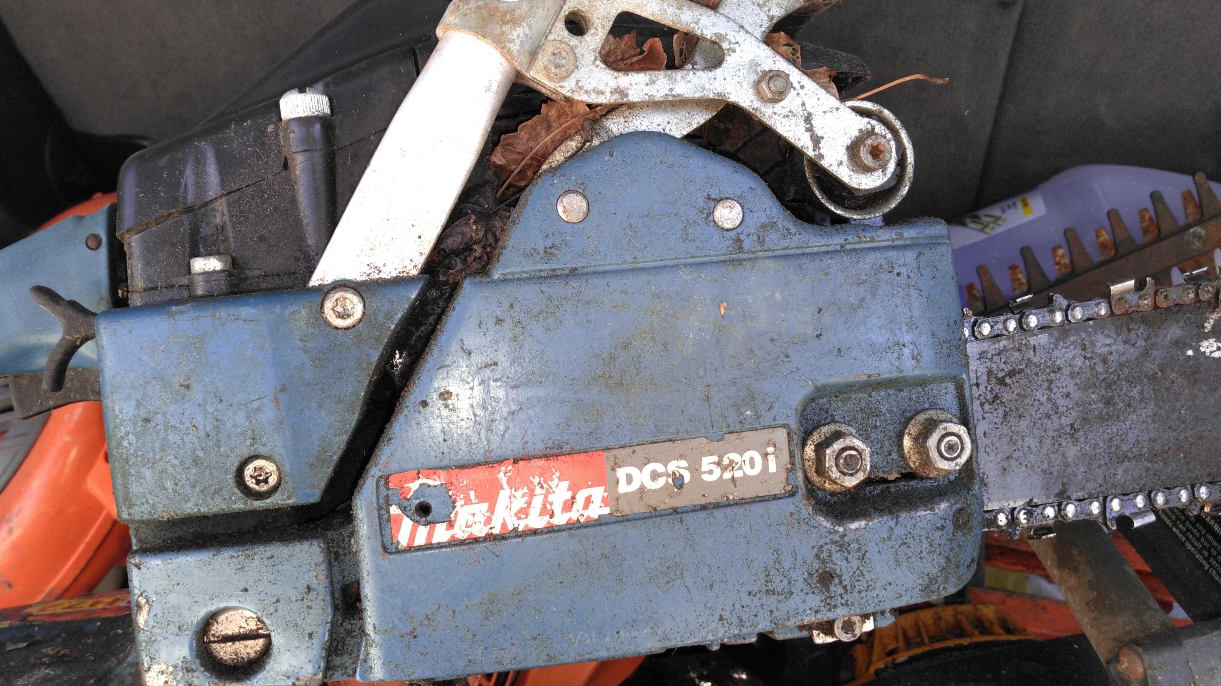

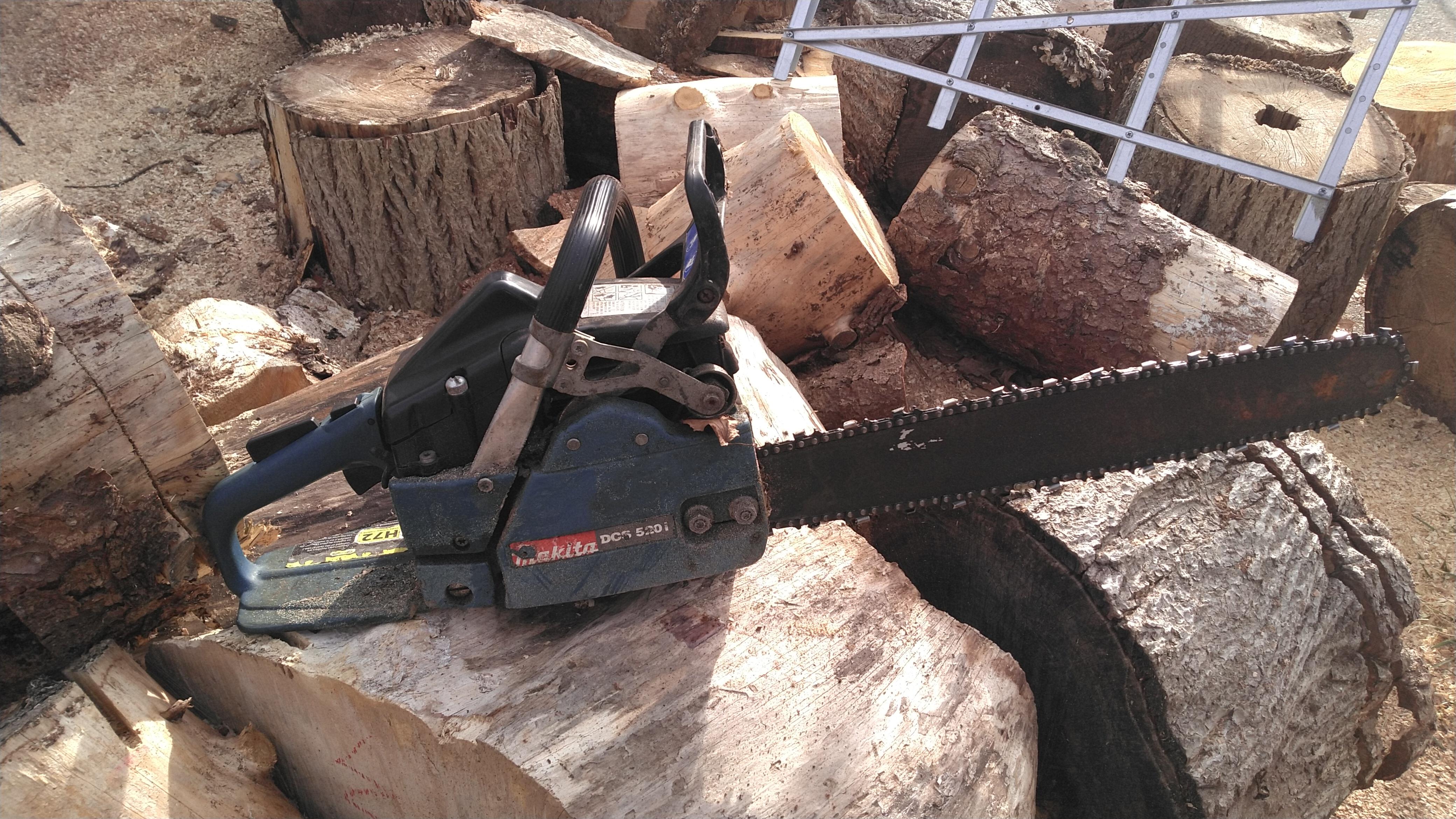

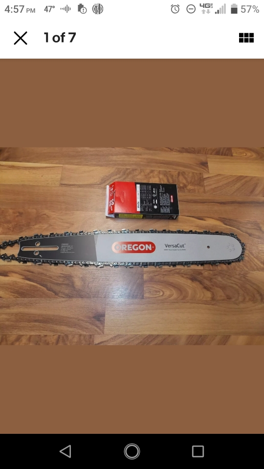

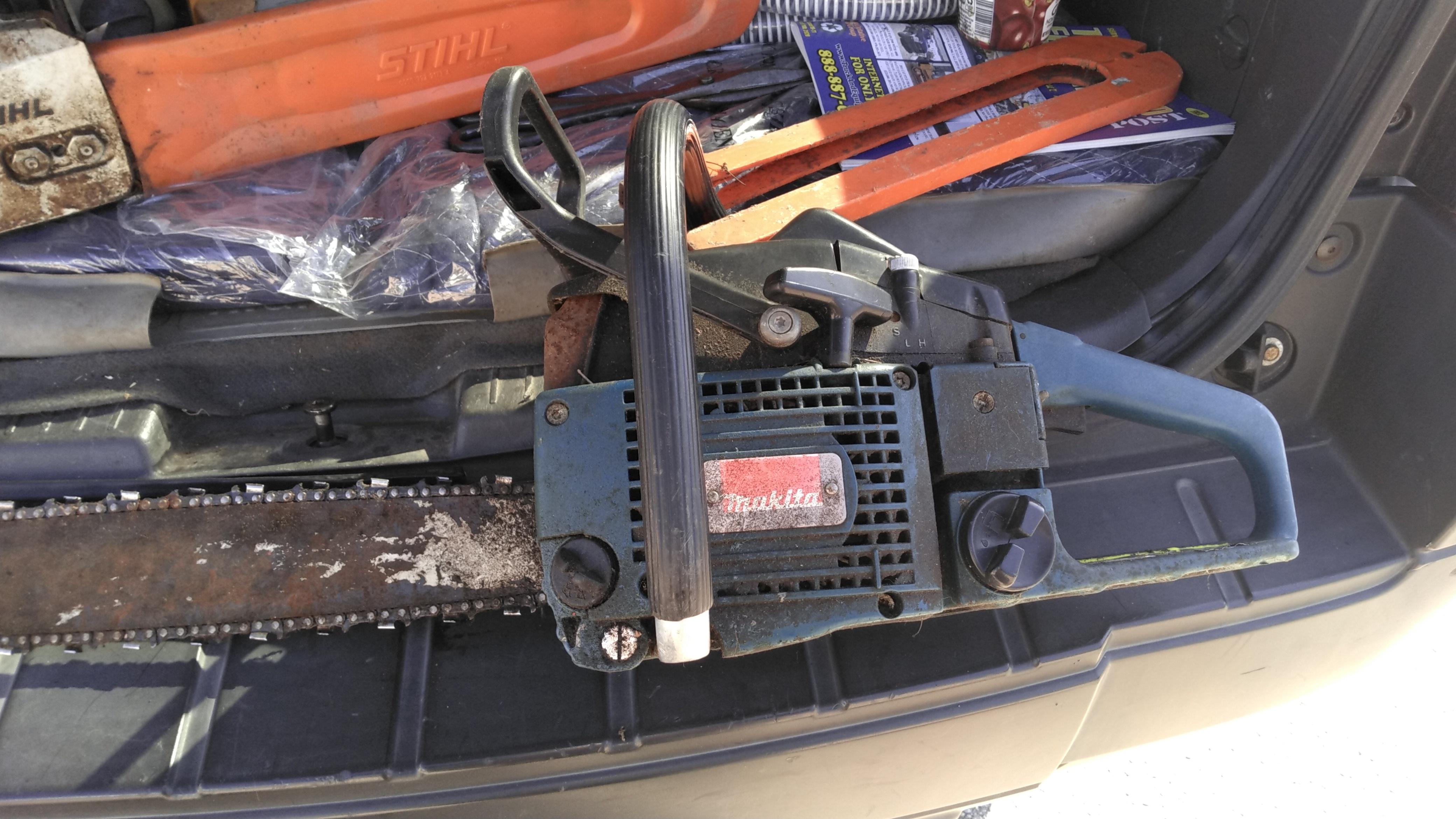

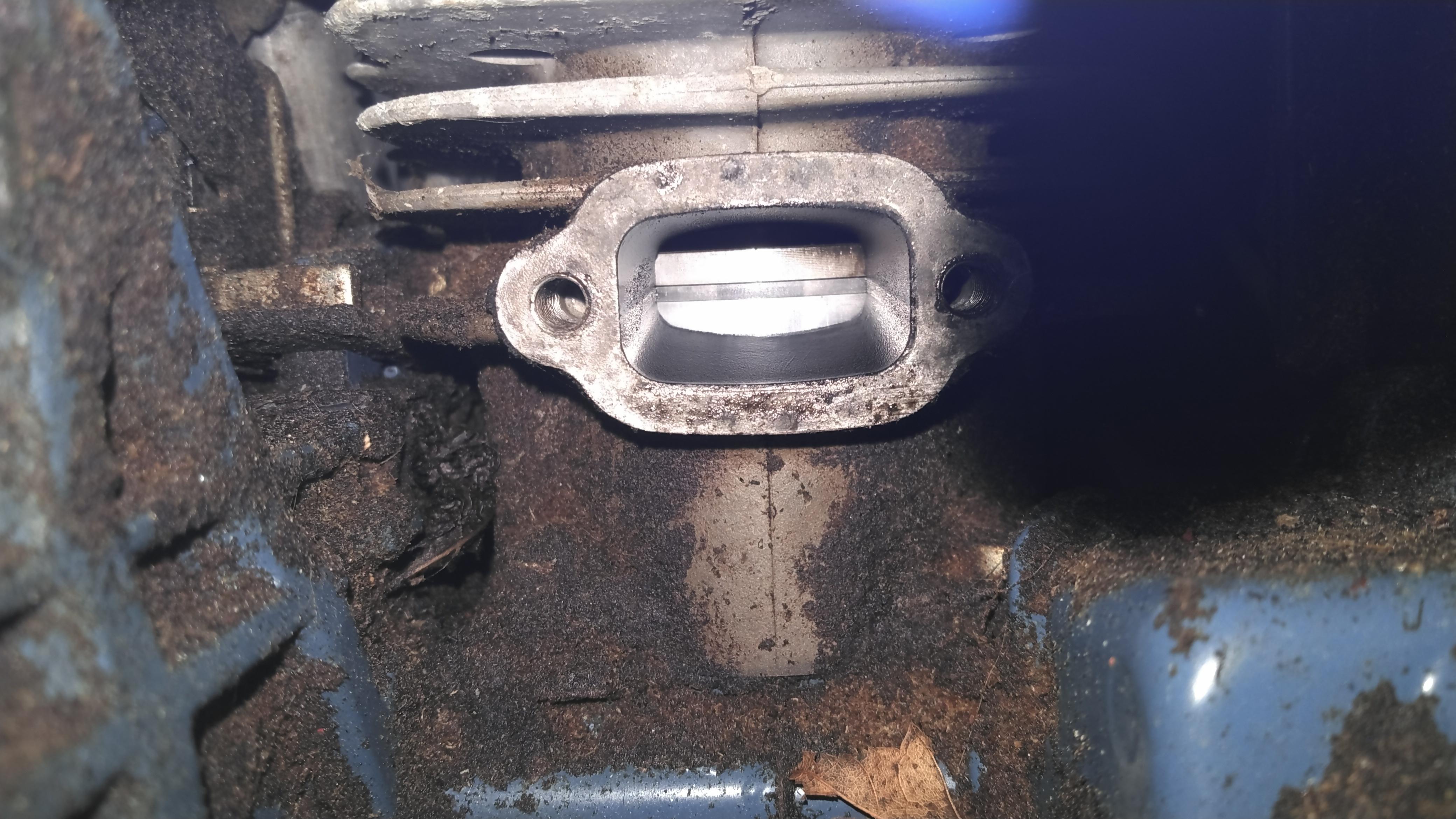

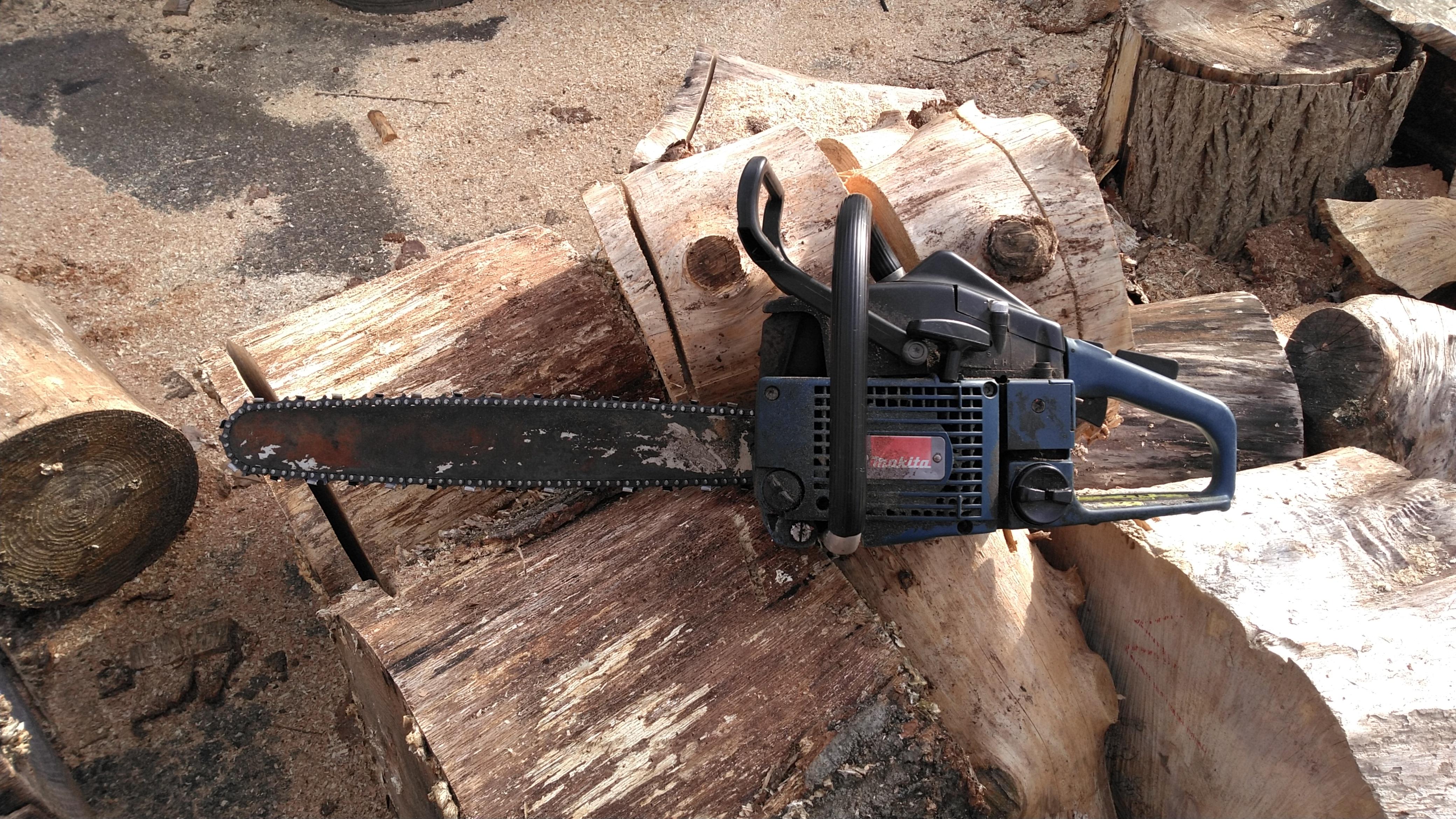

Picked this dcs520i up last weekend. Fresh fuel, oil, a new plug, and carb tweaking had it running pretty good. Still have to get a new bar/chain and a bucking spike for it. Still needs some fine tweaking as well.
