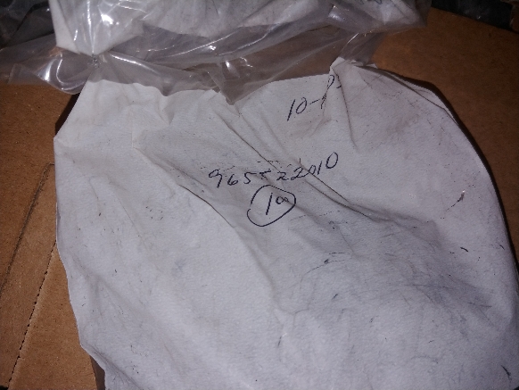

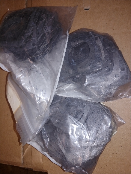

How many 105/108 cylinder base gaskets do you need?
Holy cow! :eek:
If You'd be willing to let go of some parts I would like a few cylinder base gaskets, possibly a piston kit or two.
