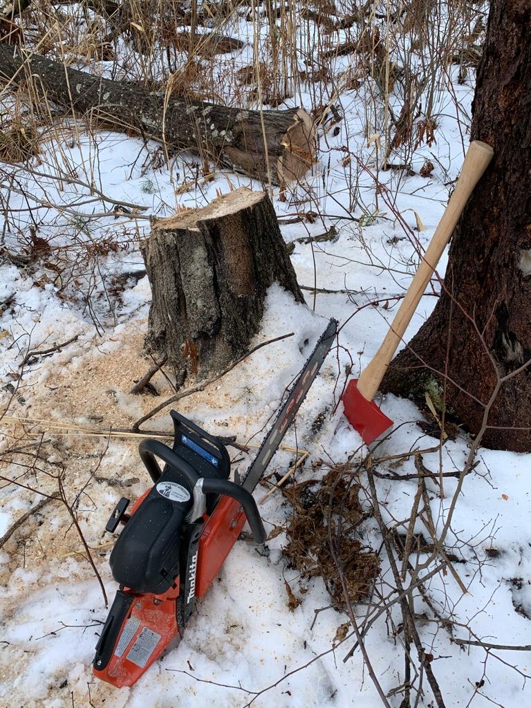

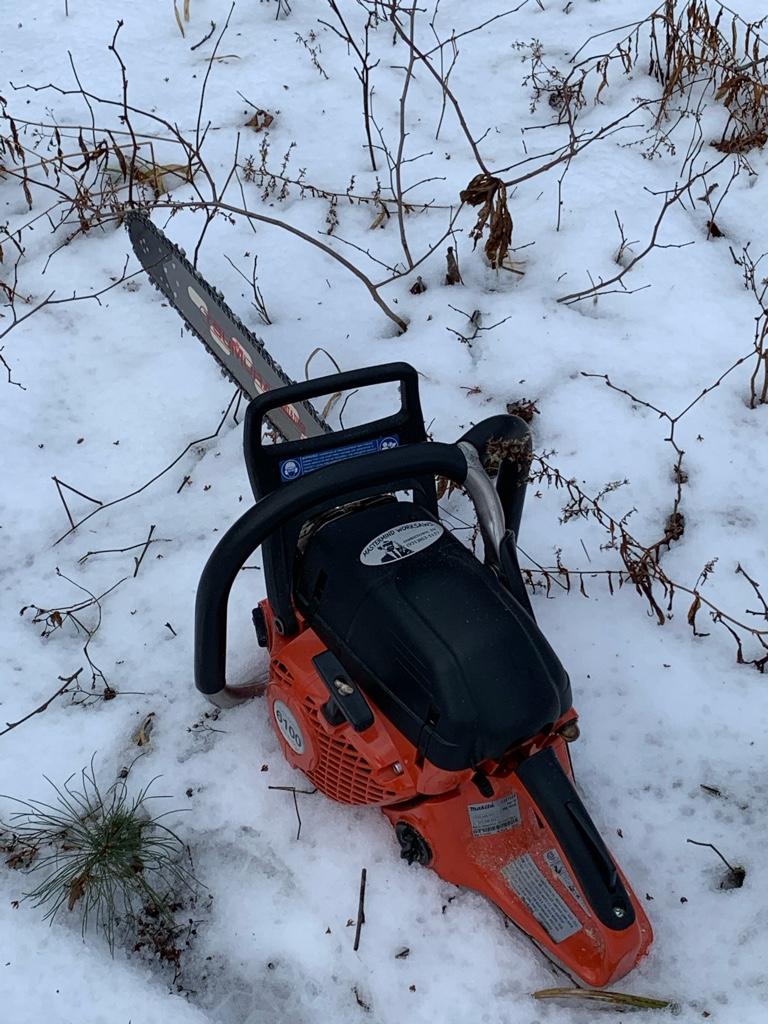

Dropped a dozen trees with the 6100 today. She did awesome. Way better than me. Lol.
