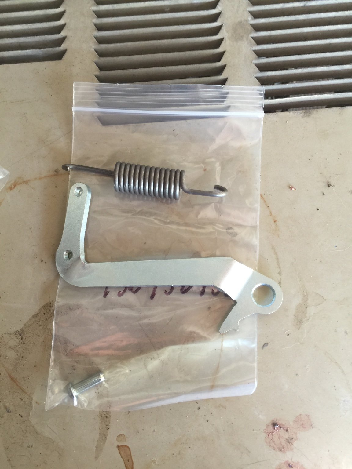

Ok Dolmar gurus. I need help. Got the spring put on, but didn't use the new arm because my bolt is actually too small for the new arm. I can't get the brake to stay released. Just the vibration of the engine running will trip it. Am I missing some sort of catch?
Shawn,
Pics of how you have it installed/ set up may be of assistance.
Steve would know. @166

Will get one as soon as I get home.
I copied the pics I received from leeha.
Pretty straight forward, or so I thought
Agreed on it appearing straight forward, but lots of Dodads, and Thing-a-majigs.
Also compare the brake arm you were sent, to the one on your saw. If the one you have is bent, it will affect tension.

The arm I received needs a different bolt than the arm on my saw. Upgrade perhaps?
I'll dismantle it again shortly and provide pics.
