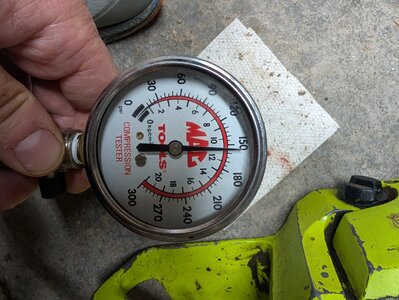

Hey all.
I picked up a Poulan Pro PP295 at a flea market for a few dollars. It appears to have lived under an oily sawdust pile for the past several years. First time delving into anything on the yellow side. I have to say the cable throttle linkage was a bit of a pain to deal with....
Fuel line broke at the tank and the air filter was nasty, so figure that's why it was put away. But, I checked compression and it's low 100's. I tried to pull the muffler, but it's not coming loose. From the IPLs I can find it looks like I have a type 1 or 2 (tag is missing), so just two bolts on the outside of it, and I am guessing one is inside.
Questions for you guys: Is that compression too low to bother with? Any tips for separating the muffler halfs so I can get a gander at the piston? Looking through the plug hole it doesn't look like scoring on the exhaust side of the jug...
Thanks!

Squirt some mix in the spark pug hole and see if it will start.
That will get some lube in there. Some saws sitting for a long time might have a dry cylinder or stuck rings.
As far as the muffler bolts go, use some heat on the bolts.
A peppy saw for what they are.

Thanks for the ideas!
Wanted to clarify I can get the two external bolts out, but I think there is one more inside the can I cannot get to. I'll have to see if I can heat up the seam to get it to pop open for me.
EDIT: It runs for a second with fuel poured down the plug hole, so that's something. Guess it's worth trying to fix it up....
Secondary question. Does anyone know off hand the o-ring sizes for the fuel and oil caps? I'm pretty sure these ones are shot. I can measure, but didn't know if it was a common knowledge sorta thing with these saws...

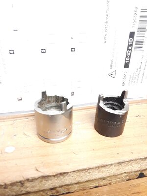

I don't have the tool that fits the clutch, but would an adjustable pin wrench for an angle grinder work? Or I can try to find some pins or bolts that will fit and find a way to hold them at the right spacing. I tried using some plates from a brake caliper tools set that I have, but none of them lined up appropriately.
I made a few sockets that work well on clutches. Take an old or cheap socket and cut down on them with a hack saw and break the piesces out af the socket to leave two opossing tabs. Works well.clutch_sockets[1].jpg

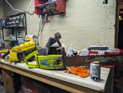

Well, I managed to find enough time to get the PP295 put back together. Carb needed a cleaning (sawdust in the screen), a kit for stiff diaphragms, new AF and new fuel lines. What a pain these are to reassemble! (I am mostly used to Echo/Sthil stuff) Anyway, it was popping off with a squirt of mix down the carb, and ended up running after the H/L screws were turned out maybe 3.5 turns each. Probably the most out I have ever had on a carb. Not sure if that's just the nature of this saw, or if it means I am trying to chase a leak I don't know about.
Managed to get it to idle down and stay running for several minutes. Need to have some more time to try and tune it a little in some wood and see how it does. I will say it seems like it oils like no tomorrow. There was a mess all over everything after I turned it off. Also not sure if its because I didn't cut any wood, so all the oil just kinda pooled and ran around the bar, or if Im actually leaking a lot of it out at the oiler port.
Appreciate the help so far, and any other tips for getting this one dialed in. I have some old beams I am planning to use this bar/chain on, and then planning to put an adjuster on it and get an 18" or 16" setup for it, keep it on hand as my backup/loaner saw.
