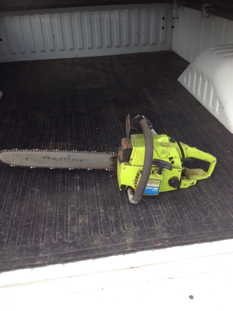

My buddy picked up this 3400 at the scrap yard for $10.
It needs fuel and vent lines, fuel filter any vent. Anyone have this stuff?

Tygon 0.117 x 0.211 will work. There should be a double-barbed plastic fitting that accepts the external vent line and is friction fit into the tank hole. A green duckbill valve goes on the other end (inside tank). Any generic filter ought to work. Seals are SKF 6119 both sides and a piece of cake to get at and change if you are going that far.
Looks like $10 well spent.
