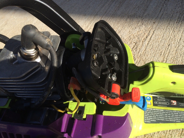

What is the baseline setting for the high and low speed jets on a 40cc wild thing type?
rocketnorton
11:29 PM
638
Jan 21, 2016
1,116
4,012
surrey, bc, can
seems all the plastic poulans I have/had like the fat side of "normal". some times a full turn or more. my elev. can be measured w/tape. 30' be overkill.
