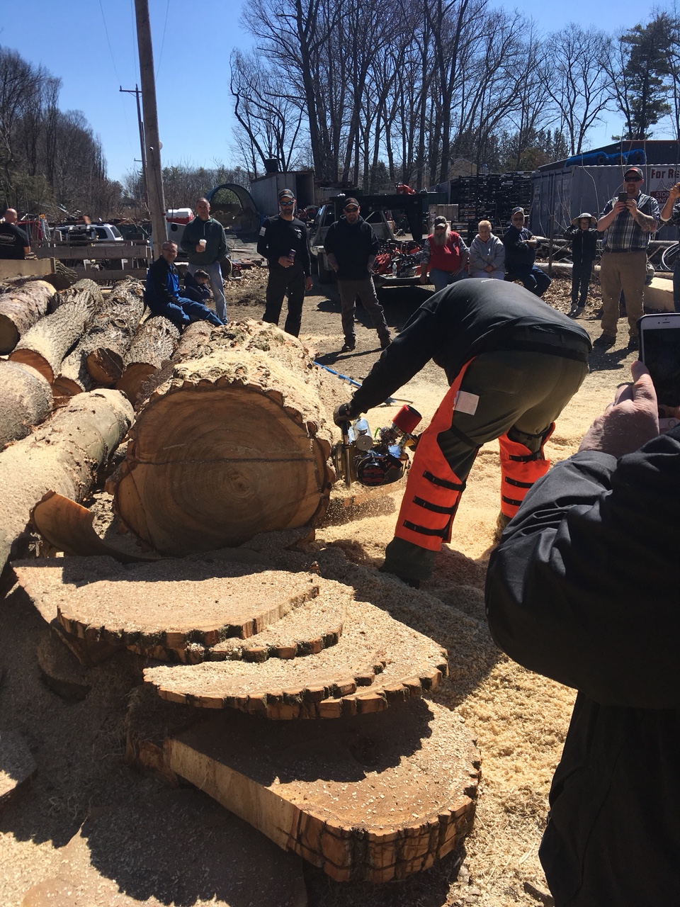

Any time you put a 101 in a stock saw chassis you are detuning the 101.
The 101's came from the factory with a carb that has a 1-3/8 throttle bore.
A few on the saw sites have gone through the pain of making stock appearing
125's with the big carb. The stock 125 muffler doesn't help either.
This one I built over a year ago using the Tillotson HR race carb. It has a 1-3/8 bore.
It is done and is a real hoot to run. If you look in the Upstate NY gtg thread you will
see a video of it running.

Sweet saws Lee!! I NEED to build something similar! I have one more 101 saw in the build phase(stock style) all of the paint is done, just need a few little parts. I have two more kart motors that I would like to play with, I really like your 797/101 with the kart carb!
