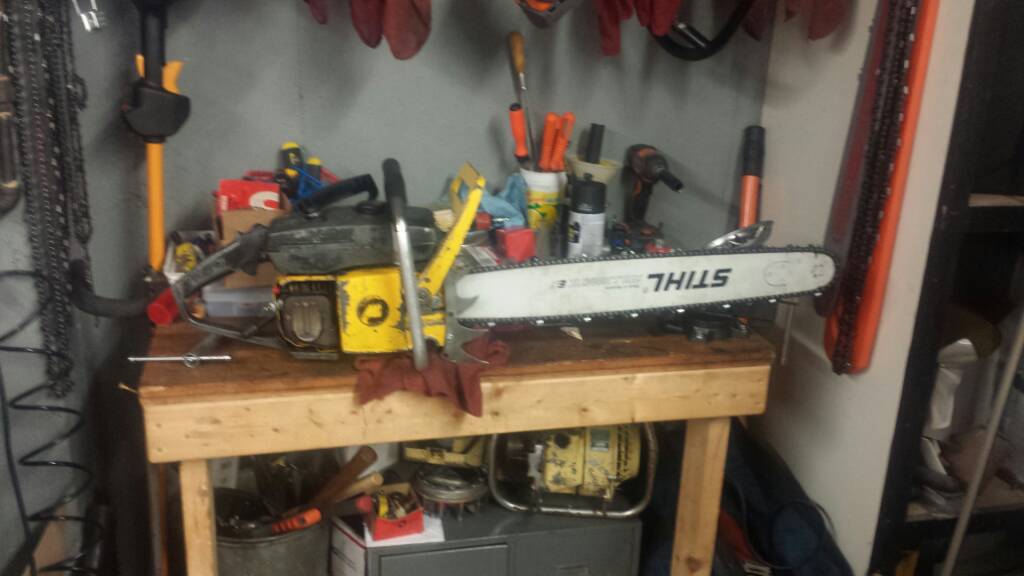

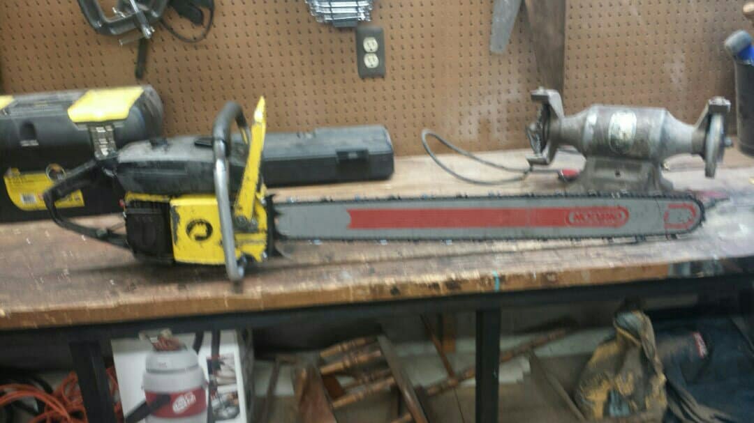

Well she's a screamer it was hesitating found out that the new style composite type fule filter was like porus plastic instead of the felt then I gave it the old one and it lit up like a crazy screaming machine I'm surprised it's pulling the 32 inch 404 bar without to much of a problem
