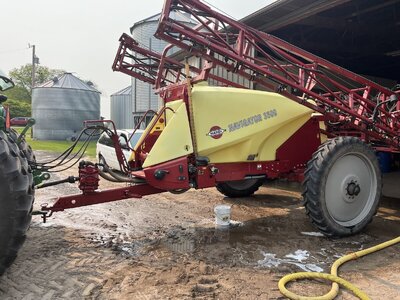

What brand sprayer is that?
Hardi Navigator 3500
I thought we were doing good going from a 30’ manual fold with manual controller to a 40’ hydraulic fold and three section boom, lol.
We still have the first sprayer we had on the farm. Likely similar to yours. A manual fold 30’ boom sprayer with a 200 gal tank. We still use it for ditches and misc stuff. It’s quite handy !

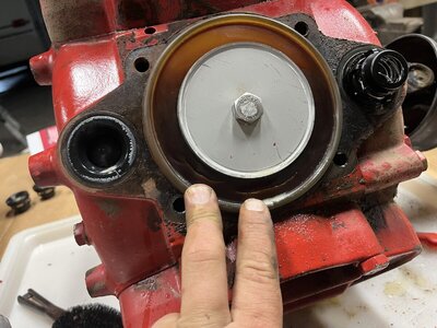

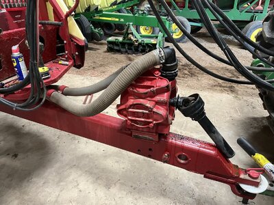

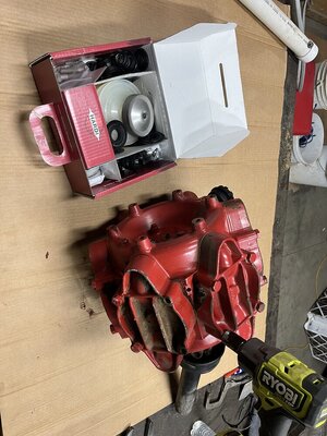

Last night I saw there was a bit of wetness coming out of the weep holes on the bottom of the sprayer pump. I have around 1,200 acres left to spray for first pass and can’t have leaks !!
So I picked up a rebuild kit this morning.

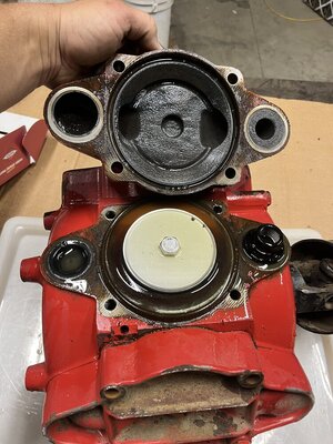

Holy crusty. It’s time for a rebuild. The diagrams are all hard and the check valve plastics are quite brittle. Definitely time.
Hey look !! This is the one that failed. Always nice to find the issue vs rebuilding something and not finding the actual issue and just hoping it works when you put it back together.
Back together and working great !! Back to the field !!

Agreed! It's almost a joy to find the root cause of a problem that could have multiple causes. At least that way you know what you're up against and whether or not it's likely to be fixed the first time. I hate trial and error repairs.
