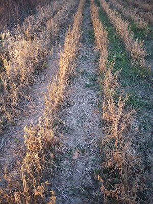

I don't work my fields no more, I leased them out.
But yes others plant autumn/winter wheats, harvest it and then usually plant corn.
Here is it tough enough to get a good year to double crop beans after wheat but the stars would have to be in perfect alignment to follow wheat with corn. You could do it with the intention of chopping it for silage but you damn sure better be prepared to chop it yourself as no custom chopper will do it unless you had a whale of a lot to chop and even then doubtful. By the time it would be ready to chop they are done for the season.
This is a picture from October 29, 2024 of some of my beans that followed the wheat.
